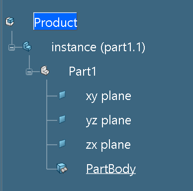

No, it's a product I'm passing
Set oManager = objProductMat.Item(k).GetItem("CATMatManagerVBExt")
oManager.GetMaterialOnProduct objProductMat,Mat
And it doesn't change if I put
Dim objProductMat As Part
or
Dim objProductMat As Product
and the material is apply to what?
Eric N.
ok i did test your code and I have the same problem
Code:
does not find material on the product if the product is a part instance... you' ll have to work with the part
so use:
Code:
oManager.GetMaterialOnPart objProductMat.ReferenceProduct.Parent.Part,Mat
Be aware that this line will fail if objProductMat is not an instance
Eric N.
Ok, thanks Eric, I will try it Tuesday when I come back to the office but what is an instance exactly?
this is 3dx 2016X but V5 logic is the same:
Eric N.
Ok I'm back to work and I tried the modification, I still can't get the material even though I think i have the same configuration as you (with what I think is an instance)
