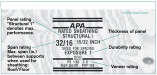

In TABLE 4.3A of the SDPWS (2015 edition), wood structural panels have a higher unit shear capacity than regular plywood siding. However, I am not seeing what constitutes a wood structural panel. APA Structural I or APA rated sheathing stamps are easy enough to read, but I cannot tell if the following meets the requirements.
PS1-22 EXT AC 15/32 CAT. Grp. 4 0 0.453 IN
MEETS UNDERLAYMENT REQUIREMENTS
I specified Structural I or APA 24/16 rated sheathing, but the contractor wants to use plywood stamped with the info above.
My question is: what constitutes a wood structural panel? (What standards does it need to meet?)
C4.3.3 (in the 2015 SDPWS) somewhat gets into this, but it does not explicitly state where the line is drawn, or I am not understanding it.
Thank you all for your thoughts.

Sorry I left out arguably the clause which answers your question:
SDPWS 4.3.7.1, Article 7: Wood structural panels shall conform to the requirements for its type in DOC PS 1 or PS 2.
Great graphic above. Rated sheathing and Structural I will be labeled as such.
The APA website that RWW also linked has endless plywood info to answer all of your questions.
If it doesn't say "rated" then I don't approve it as such.

From my understanding of the APA, the APA rated plywood meets the specs of PS1 & PS2 as well as additional APA specs. However, I am wondering if this is the minimum requirements to consider plywood a wood structural panel and treat it as such for unit shear capacities (SDPWS table 4.3A) or if plywood that meets PS1-22 (but not APA rated req's) could also be considered a wood structural panel sufficient for the shear loads given in the aforementioned table.
I know the plywood already partially installed by the contractor does not meet the requirements specified, but I am wondering if it needs to be replaced or if it meets the minimum requirements to be considered WSP and therefore can work for the shear walls.

I'd be concerned something that "meets underlayment requirements" isn't really meant for use as a wall panel. It's possible, but my curiosity is raised. That sounds like it's rated as floor sheathing and roof sheathing, not strictly intended for (highly stressed shear) walls.
Maybe it's just me, but Structural I (capitol "I") sheathing isnt something most engineers would just randomly slap into their general notes as some kind of "screw it i don't care" specification, meaning the structure needs it.

NDS 9.1.1 & 9.1.3.1 defines plywood as a wood structural panel.
NDS 9.2.1.1 says that design values must come from an approved source.
SDPWS 2.1.2 points to itself and to the NDS.
PDS 2020 (APA's Panel Design Specification) 2.3.1: "Structural I sheathing panels meet the requirements of sheathing grades as well as enhanced requirements associated with use in panelized roof systems, diaphragms and shear walls for increased cross-panel strength and stiffness and increased racking shear resistance."
Panels can be graded sub-Structural I and still be span-rated strong/stiff enough for your purposes, depending on the thickness/number of plies.
All that said, Group 4 is pretty weak/low on the scale (Refer to PS 1). I doubt this works.
Solution
