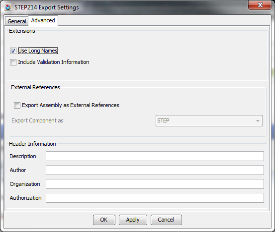

Also, you DO NOT need to have External References ticked ON in order to export an NX Assembly with the asm structure intact. When that option is turned ON and the Export Components pulldown is set as NX, it will export every component and sub-asm as NX files. If Export Components is set to STEP, it will do the same except the components and sub-asms will be STEP files. If you turn OFF External References, you will end up with a single STEP file that opens with the entire assembly structure intact. I prefer to leave the external references OFF.

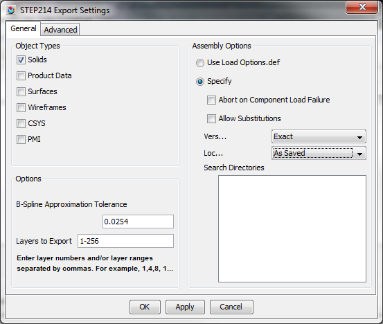

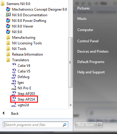

I use the external translator for maintaining assembly structure and multiple components. I use it very often and it always works. You may need to adjust the "Layers to Export" or check the types of geometry you want.
EDIT: You only need to select the assembly(s) that you want translated. No need to select components.
