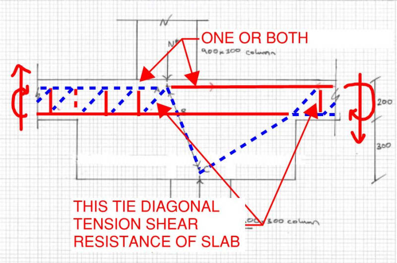

I have been a long time lurker on eng-tips and have finally found the need to make a post for myself.
I have recently become familiar with Strut & Tie modeling and am currently faced with designing an offset column attached below. I have tried designing without a drop panel and my tie forces were far too high so added the drop panel in to increase the angle between the strut (black) and the ties (red). I know it would be ideal to have my bottom tie at node C however we do not detail reinforcement in the bottom of our drop panels at our firm.
I am wondering if my current model is reasonable (or even possible) with node B being midway through my strut. Am I missing additional struts or ties? Is this even a Strut & Tie problem or can I use standard methods of analysis? I am having trouble finding the resultant tie forces as I get different results when using the sum of all forces/moments or using simple trig so I'm assuming I am missing elements somewhere.
Any help would be greatly appreciated. Thanks.
This has a number of problems. Node C isn't in equilibrium. The strut AC would actually be two struts AB and BC. The force in the lower tie that connects to B must be zero because the AB and BC forces must be equal for vertical equilibrium so there is no unbalanced horizontal force.
But more fundamentally, you're trying to avoid reinforcement at the bottom of the drop panel. You can't say you'll design by S&T then exclude ties!

With the smallest of model tweaks, you'll be good to go with no bottom of drop reinforcement.

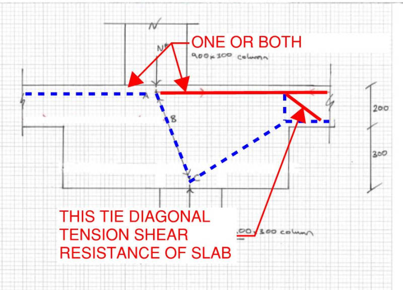

KootK, what does it look like if you get rid of the drop?
I would say that it looks the same but with shallower angles.
Confirm for me that the horizontal compression strut would be much easier to just ignore from an analysis standpoint on the left side?
Also it appears (and maybe my analysis is a bit rusty) the lower column will see a slightly amplified force due to the restoring compression struct on the right side.
Edit: realized without diagonal tension resistance, you can't resolve the vertical compression.
Lastly, would it make more sense to take out the tension using the slab bottom bars as shown below in pink(assuming they exist through the drop panel), as opposed to relying on the tension shear resistance of the slab.
Confirmed. However, I prefer to show it as I do because:
1) My preferred approach here is to show as complete and accurate a picture of things as I can and then let OP pare it down to what she really needs. If the extra complexity results in extra confusion for the OP, I consider that a benefit. That confusion, in my mind, indicates an incomplete understanding of the situation a need to push a little further with respect to asking questions etc. To this end, I submit for consideration the even more complex, even more complete model below. I held back on this because the villagers tend to get antsy when they see ties crossing struts, partial depth model usage etc.
2) In many cases, where the joint is in the interior of a slab, the fact that the primary strut can push against adjacent, semi-infinite concrete is a) very comforting and b) can be used to advantage. As such, I feel that it's important to acknowledge the existence of that load path. Most of time, I suspect that it's actually this mechanism getting most of the job done. It's a rare building owner that would want to "see" their ties working when they look down at the top of a slab joint.
3) I think that it's key to a complete understanding of S&T to recognize that, wherever a tie bar is developed, there is a compression strut over lapping it that a) represents bar development and b) is not explicitly recognized in our S&T models. Whenever you think that you're pulling on a bar, you're also pushing on a cylinder of "development concrete" that surrounds that bar. For this reason, I feel that it's somewhat arbitrary, for a situation like this, as to whether or not one chooses the push or the pull as the designated path coming immediately out of the joint.

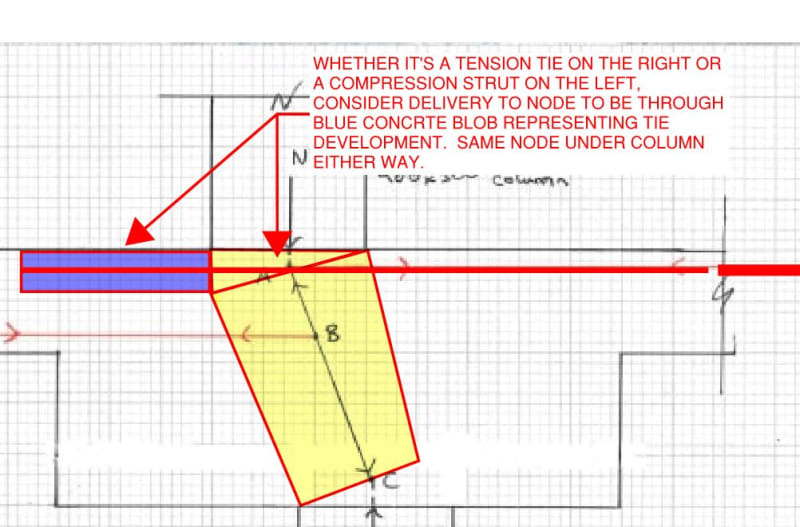

KootK, I understand the concept behind the development of the tie causing an overlapping strut, however, if I was to consider the horizontal strut at A along with the tie I would have 4 elements coming off node A. Is this consistent with STM theory or does it need to remain at 3 elements to a node for the sake of simplicity/calculation?
Ar_Engineer said:
KootK, I understand the concept behind the development of the tie causing an overlapping strut...
I suspect that there is still a degree of misunderstanding on this point given your question about the four elements coming into node A.
1) I know of no hard limit on the number of elements that can come into a node. That said, the impulse to steer things toward something simple is certainly valid.
2) Whether you use the horizontal tie, the horizontal strut, or both, I believe that the model is the same with only three elements coming in. See the sketch below. In my mind this is best envisioned as a CCC node at A for any condition where you're able to extend the tie bars left of the joint meaningfully. It's only a CCT node at A if you're geometrically constrained with an edge column condition etc. And if that's the case, many a designer would include a headed bar or a weld plate on the ties to, effectively, bring it back to a CCC condition.

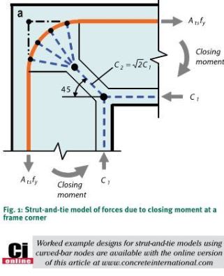

I just want to know who in their right mind uses solid red lines for ties and dashed blue lines for struts...
- I dunno, I feel as though I have been in my "right mind" thus far.
- Is there some kind of ISO standard for this of which I'm unaware?
- Almost without exception, I see struts represented as dashed.
- With respect to what is hot colored and what is cool colored, I've seen plenty of both.
- Example below from a Concrete International / ACI.
Tongue in cheek, KootK. Always thought of compression red being angry and sporadic (dashed) and tension blue being the calming influence of clearly defined (solid) rebar.
Noted. Your scheme does have appeal. I've always thought of red as representing "mission critical reinforcement". And blue as representing "relax KootK, the concrete will probably never ever crack anyhow".

This one worries me. You can draw nice lines like that and tell the concrete where you think the forces will go. And yes, eventually the forces may go there. But the rotation is still going to happen. The slabs either side of the connection are not stiff enough to stop it and the forces in the struts still result in a high rotation.
As an very experienced engineer commented to me on this S/T arrangement,
"Most concrete structures did not go to uni to know how to behave...".
I agree rapt.
I always remember a lecturer in college shouting at one of my fellow students.. I don’t remember the context, but I always remember his words “...WELL THE CONCRETE DOESN’T KNOW HOW STRONG IT IS!!!”
I wouldn't treat a CCT node as a CCC node just because it's possible to anchor the reinforcement beyond the node. This is an implicit requirement of S&T design. CCT nodes have lower capacity because there is tension in one direction which 'activates' the tie. The opposite of the strength increase when concrete is confined with transverse compression.
And I agree with Rapt. If you're going to make up a load path in the S&T process (ie make up boundary stresses rather than take from earlier analysis), you should check what deformation is required to achieve those boundary stresses.
