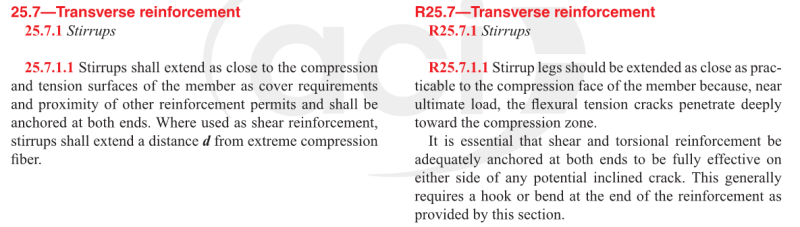

1) The ACI document clips shown below make it clear that, on some level we do care about the height of the studs. The supplier tells me that the only reason for the limitation is that engineers used to try to sandwich the stud heads between layers of tension steel which was goofy.

just like there's a reason the code says that if that was a stirrup, it needs to be hooked around the flexural reinforcing.

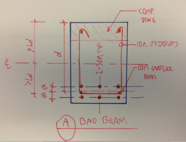

These statements really get to the heart of the matter in my opinion. Do stirrups have to make it all of the way to both the tensile steel and the compression zone? I'd like for that to be the case. And ACI enourages it without being very specific about how close is close enough. They also state the reason as being limited stirrup leg development capability near flexural cracks rather than a specific need to connect the tensile rebar and compression zone.
Consider the common FRP reinforcement scheme below where, in all likelyhood, the reinforcement would not make it into the compression zone.

As a hypthetical that I would never do in practice, consider the beam shown below. I believe it code compliant depending somewhat on your definition of "as close as possible". I also think that it is quite analogous to the stud rail situation.
