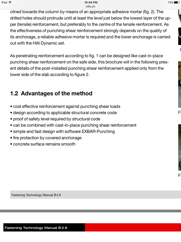

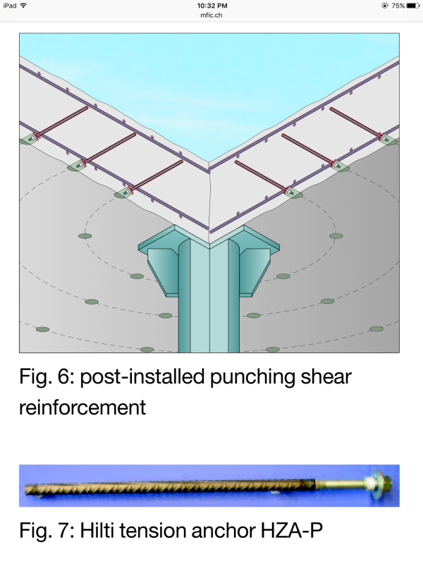

Hilti Europe has a solution. I won't employ it though since, somewhat ironically, it probably wouldn't extend any higher than my errant stud rails. Perhaps that, in itself, lends support to sandman's line of thinking. Presumably Hilti would have done some testing.
Spoke too soon... Hilts has an identical requirement for their system.

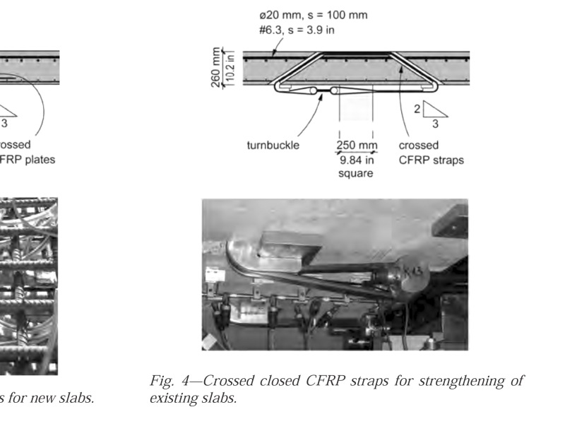

Here is a FRP solution from some Swiss researchers:
Carbon Fiber-Reinforced Polymer Punching Reinforcement and Strengthening of Concrete Flat Slabs: Link
Check out these two FRP-based solutions:

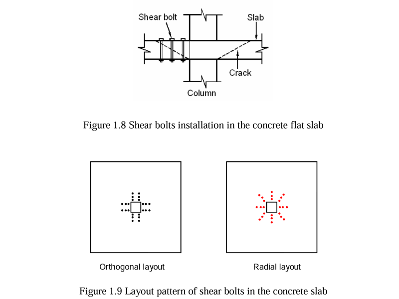

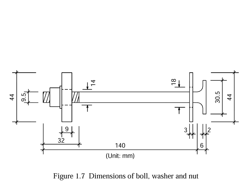

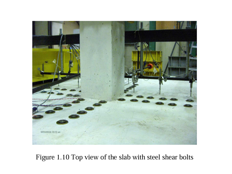

Following from rapt and MacGruber22 comment on using through-bolts, a PhD thesis from U of Waterloo researched the use of Decon manufactured studs (with the forged head) and on the free-end of the stud they cut threads and used plate washers.
Punching Shear Retrofit Method Using Shear Bolts for Reinforced Concrete Slabs under Seismic Loading: Link
Looks like the radial vs orthogonal arrangement discussion still has a ways to go.
hokiee66, I am not sure if you are referring to the thesis I referenced, but if you are the research (dated in 2008) did include both orthogonal and radial shear bolts.

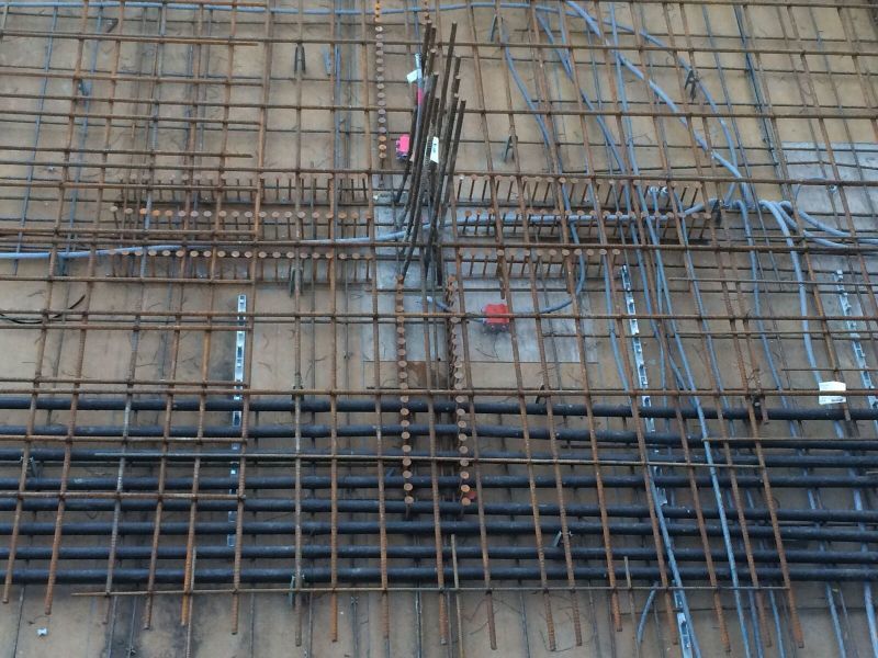

The following photo is taken from your earlier thread which you referenced in the OP, namely thread507-399858
It appears to me that the top of studs at this particular column is close to the top of the top steel. If the height of stud is one inch shorter than specified, does this mean that the top bars are lower than specified? Or does this mean my eyes are playing tricks on me?
Were any of the electrical conduits moved as a result of your earlier concern?
BA
Here's what I can say BA:
- the two issues were identified on different floors.
- QC didn't pick up any issues with rebar height on either floor.
- I doubt that QC gave stud height much scrutiny. As an item fabbed in a plant, we rarely have problems with them (other than install) once shop drawings have been reviewed.
- the conduit was not removed. Firstly, the rail suppllier wasn't worried. More importantly, the rails supplied were double the length of the rails specified. The conduit didn't actually impact any of the "specified" studs.
One of the most frustrating aspects of these substitutions is that they wreak havoc on our quality assurance review process.

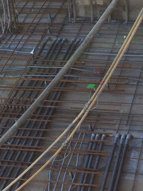

Yes, that would be frustrating, I agree. It is difficult to know whether or not there is a problem based on the photo above.
The other photo, shown below, seems to indicate that the elevation of the top of stud is about right relative to the top reinforcement, but it is difficult to tell from a photo. Also, the top steel may not be in its final position at the time the photograph was taken.
