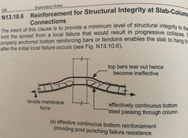

1) Above, I mentioned the case of a non-prismatic slab (quoted below). It seemed to go under the radar with the group here but I find the example quite salient. In plaza and parkade slabs, having a slab top surface slope that differs from the soffit slope is a common occurrence. Depending on whether or not the designer chooses to slope the top rebar to match the soffit or the top of the slab, a situation may be created where even proper height studs will not make it to the tension steel. A mere 2% difference in slope would be enough to create a 25 mm shortfall at the end of a common length rail. I take this as anecdotal evidence that it is in fact a relatively common occurrence to have less than full height studs. And, to my knowledge, there have been no consequences to that.
2) In Canada, our integrity reinforcing provisions for concrete require us to install integrity bottom steel at all columns to provide a secondary path for punching shear. In that respect, we do have some forgiveness at the ULS condition.

My understanding of integrity bars, maybe different than in the Canadian code, is that they provide flexural capacity for seismic loading. They may have some benefit for gravity caused punching shear, but more top steel is more important.
hokie, that is what I thought. In ACI 318, they are merely a prescriptive quantity of continuity bars. And yes, I don't follow the bottom bars doing anything here.
"It is imperative Cunth doesn't get his hands on those codes."
In the Canuck code, most of the integrity steel provisions are just as you've described. Not so for the Slab-Column provision however. The mechanism of resistance is literally a tensile "hanging" of the slab from the bottom steel passing over the columns. It's meant to represent a ULS mechanism that, should it be activated, would surely render the slab unserviceable from that point forward. Technically, no top steel is required.

Re the integrity reinforcement, the Canadian code version can only be for Structural Robustness (i.e. it still stands up if a column is removed). Otherwise it would still be required for PT (d) in the Canadian Code clause) as the tendons will work in the slab in catenary action. So the picture above is not really correct for this case.

It is for robustness but, I believe, not in the sense that you've described. Consider: if a column were removed, there would be nothing to hang the slab from and our spiffy integrity bars would be useless. The goal, as I understand it, is to prevent a punching shear failure at one column from instigating punching shear failures at adjacent columns and subsequently pancaking a large section of slab.
It's the picture that CSA provided in the CSA concrete code to explain those provisions. More or less the same material shows up in the European provisions and ACI352 as shown in the clips below.

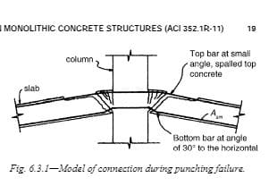

Based on the snippets below, Canada, Europe, and the USA seem to have found a defined and quantifiable way to to increase the punching shear capacity of the secondary punching shear resisting mechanism.
If you remove an internal column and there is continuous reinforcement, the slab can hang as a catenary between remaining columns. Thus rapt's robustness comments.
I am unfamiliar with the term "secondary punching shear", but it looks like to me the bottom bars through columns represent strictly integrity reinforcement to prevent seismic collapse.

It's not jargon of any kind. The primary punching shear path is Vc/Vs. The secondary punching shear load parth is the integrity bars. And, were there yet another load path available, it would be there tertiary punching shear mechanism.
Seismic loads do not enter into the computation on if the integrity bars in CSA. But, then, we don't explicitly consider vertical seismic load either. To my knowledge, there is little if anything that is seismic specific about the general integrity reinforcing requiremeets in CSA/ACI.

I realise that, but CSA23 3_04 clause 13.10.6.3(d) says it is satisfied for prestressed slabs as long as draped tendons are placed over the column capital. So no bottom reinforcement required.
In an RC design this bottom reinforcement is lapped with the normal bottom reinforcement so that you have both Robustness if the column disappears because of the continuous bottom reinforcement and ductile punching behaviour.
In the prestressed slab, the tendons will provide robustness in catenary action, but not ductile punching behaviour.
Which leads me to think that the Canadian Code clause is for Robustness and not ductile punching behaviour as one of the possibilities they define will not provide that!
As I mentioned above, the bottom bars are being used identically in ACI352.
