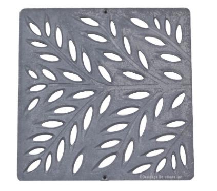

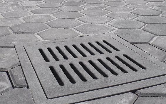

Consider running a raised concrete lip down the driveway. There are countless high-tech concrete patching and machine-mounting high strength polymer based concretes that will stick like glue to clean existing concrete. Section off most of the driveway so only water that exceeds this new lip actually makes it into the current grate. Realizing that the water coming down the driveway is only a few millimeters deep the little curb doesn't need to be too high. Perhaps an inch?
Then where the little curb makes the deepest puddle due to your driveway grade, saw out the concrete for a LARGE sump, perhaps 36" or 48". This is out in the open so a conventional concrete saw can be used or even a skillsaw with a masonry blade if you're handy(desperate) and willing to trade hassle for labor costs.
In this design include where to get the power to run the new sump. The power can be a 3/4" pvc conduit cut in the concrete to the nearest garage wall where a transition onto the wall and regular conduit to the house supply happens, so include concrete sawing to encompass that.
Now you need to provide for the pumped out water. Saw the concrete for that exit. This time make it 3" pvc from the start. Sawing concrete outside, standing up, with sawing equipment, is nearly trivial as compared to the close corridors stuff being considered.
Leave the existing poorly done scheme to handle only what the added concrete gutter misses. Change nothing on it.
Grate/sump stuff is everywhere at any landscaping/sprinkler supply places. Concrete is cheap.
Don't waste your time trying to make the %#($& existing setup work right.
or get arty
