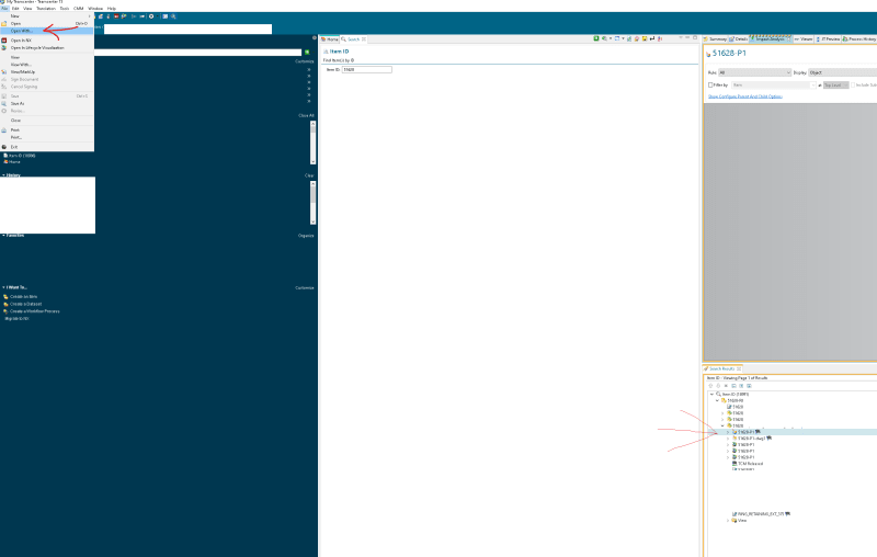

SDETER
Personally I think the version drop down would be all that is needed. If one of us do accidentally save over it, they can still retrieve the previous save. Getting that across to the hot headed leader is the problem. I may need to talk to another leader on this first. lol
Its funny because I learned how to retrieve a previous saved version once before a long time ago. The last couple times I wanted it, I could not remember how to do it. lol
Unfortunately when I try your directions it doesnt do as I expect. When I go to OPEN WITH, the window that pops up has a small drop down for application. The only application available is Structure Manager. No matter what I select inside the window, they are all Structure manager.

I do not know if these images will turn out.
This is how it works with our teamcenter, yours may be set up a bit differently. I think there a couple different ways to get to these versions, someone else may know this solution.
This thread above also has some other things you can try, to get back to your earlier versions.
That helped. I was able to see the exact file type I needed to click on. I was clicking on the upper level where it gave the file number and rev level. Im guessing this was my lack of knowledge when it came to what exactly a NX Data Set is. lol
