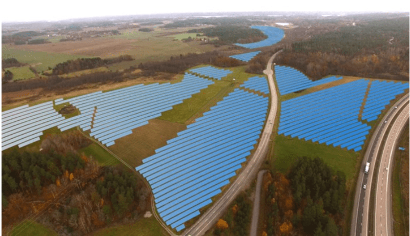

There was a reportage about solar panels yesterday on TV.
HSB is Sweden's largest housing cooperative, they have started to build solar parks by selling shares to those who rent apartments in their housing stock.
I guess they get reduced electricity costs exactly how it is financially structured, I do not know.
At the same time, they are trying to increase biodiversity by sowing natural flowers and grass between the solar panels.
In areas with large areas of agricultural land, there is little biodiversity.

Yea they tried the solar farms here, and selling shares. The last one could not seem to sell all the shares, and went bankrupt.
No as a utility we did not buy it. I might have expected us to, but we did not.
Maybe the difference here is, that it is Sweden's larges housing cooperative and it is in line with Sweden's CO2 goals so every part of society and the government agencies are onboard, it might make it easier.
