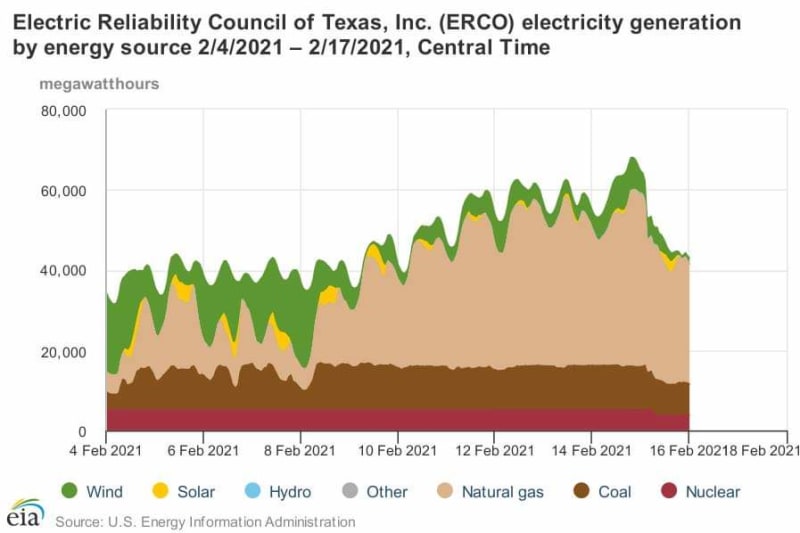

At any rate below I inserted an interesting graph of power vs time during the event from EIA. You ca look at the power over different timeframes, it's not necessarily straightforward. I'll put some numbers in but there is some subjectivity in that process.
The power sources in the graph are wind, nuclear, gas, coal. It appears coal and nuclear are baseload - they operate at constant load. It appears the wind and solar follow their own daily cycle (not following demand, just putting out everything they can which varies on a daily cycle) and the gas is dispatched in a time-variable fashion to match demand (we have to give gas credit for apparently being the most flexible among these sources).
The fraction of gas lost is (44-33)/44= 25% instantly ~4AM Moonday and (44-26)/44= 38% for the 3-day period M/T/W. Maybe I penalized them too much for starting at 44 which was probably a daily peak but oh well.
The fraction of coal lost looks to be 10% instantly and 30% for the M/T/W period.
The fraction lost of nuclear is exactly 25% instantly and 25% for the M/T/W period (1 out of 4 almost-identical plants tripped early Monday and came back Thursday).
The fraction of wind lost is 0 instantly maybe 40-50% for the three day period from the prior few days average. More importantly it decreased to 0 Monday night which is exactly when it was needed most to my thinking (that was the coldest time in my area of the state).
The fraction of Solar lost is not much but it goes to 0 at night when winter heat demand is highest so it is not helping much in this scenario.
PowerByTime_qpneb6.svg
Wind didn't have the rapid change of the others, but it was not particularly the rapid change that caused the problem in this particular event (it could in others), in this event there was sustained deficit of power generation and wind decreased as much or more than any of the other sources during the 3 day period. Abbot's comments were controversial and mostly rejected by the press. I didn't agree with everything he said but i think there's a kernel of truth in there depending on how you slice it. Certainly we know wind and solar are susceptible to weather even outside of extreme events, so it seems obvious the system should not be relying heavily on them. But then in a sense if ERCOT can't depend on their capacity when needed most then they are getting a free ride. In an unregulated environment where wind is already getting huge subsidies, it's part of the landscape to consider when comparing power sources.
I do realize there's a lot of other lessons to be learned and a lot of different ways to compare power sources. Winterization can probably be enhanced for any/all of these types of sources... they operate reliably up north, so they certainly should be able to do the same down south.

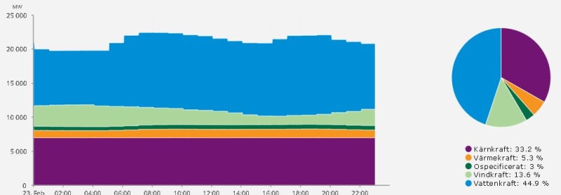

I see that there is blue for hydro in the above chart but there is no line?
Then it hard to get a proper picture when the lines are not on top of each other.
This is the chart for Sweden to day.
We use hydro to even out the wind power, I have no data on how fast ju can ramp up, but I would say you just need to pull the plug.
If there would be any possibility the create a hydro storage for balancing the wind power, for Texas and for Belgium why choose something els?
And for a small country as Belgium it will not work to be alone and not exchange power with others when needed.
And if the loss from wind farms get so great when storming it would be advisable not to put all the eggs in ones basket, rather try to have them in smaller groups in different places.
And I know it is easier in all ways to have them all in one place, and you choose location from the best wind possibility's.
But sometimes you maybe have to make other priorities to be safe, maybe not something for Texas though ;-)

> then it hard to get a proper picture when the lines are not on top of each other.
I like it in the format I had before for the purposes of judging how each type of power varied over time and what fraction of each is lost. But here is similar format to what you described for the recent Texas event. I guess it does do a better job at showing the steady increase in total demand up to that winter peak record 67GW and the sharp decrease where multiple sources tripped and then continued decrease even as demand should have been going up as it continued to get colder throughout the day on the 15th (our coldest night was the night of the 15th / morning of the 16th... where the graph stops at 00:00 on the 16th would have been near coldest albeit not a normal power peak time).
