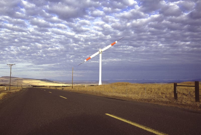

With respect to two-bladed wind turbines, that was something that we noticed when we were driving out to Palm Springs, that a lot of the wind turbines were only two-bladed and yes, they moved much faster than the three-bladed ones. Of course, as the larger three-bladed units were being installed, it seemed like the two-bladed ones were the first to be taken down to make room for the significantly larger new wind turbines, which of course were all three-bladed.

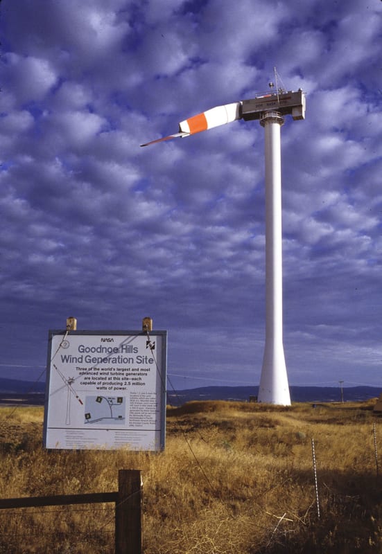

Here are some photos I took of some wind turbines which NASA was conducting experiments with. Now I'm not sure how long they had been there as we had seen the signs on the road indicating that the experimental site was there but had never stopped to take pictures until one of our later visits to the area, that is Southeastern Washington state, near Goldendale, just a few miles North of the Columbia River:
August 1984 (Minolta XG-M)
Notice how this two-bladed wind turbine used 'flaps' to, I assume, limit the speed of the turbine.

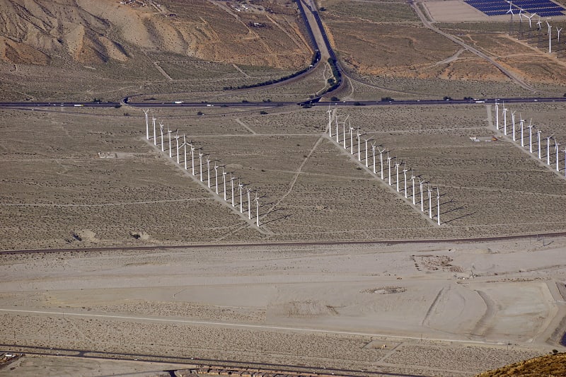

As for Palm Springs, for anyone who's never been out there, here's shot of just a small section of the wind farm, as seen from the top of Palm Springs Aerial Tramway at Mount San Jacinto State Park:
February 2016 (Sony a6000)

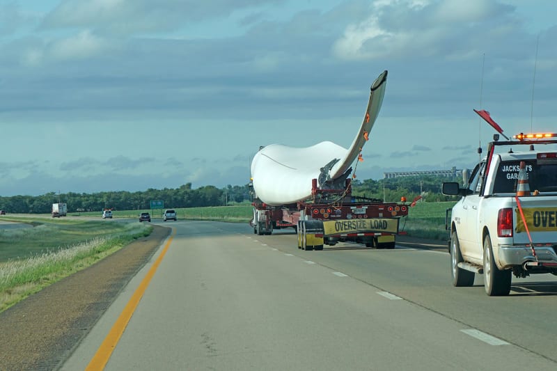

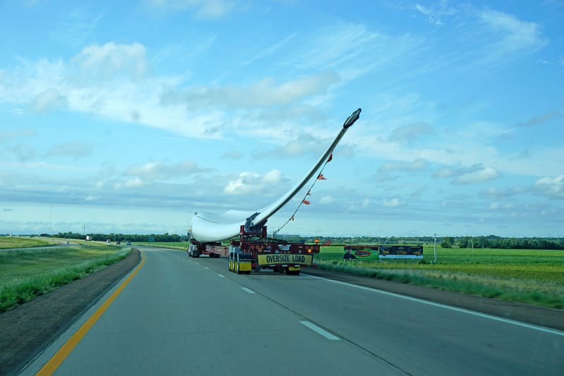

And, yes, those blades are very large. During our various travels across the country we've seen them being trucked (our course if you saw one, there would be at least another two further up the highway) to their installation site, like below near Salina, Kansas:
August 2017 (Sony a6000)

We shipped 3.8m ft of tubing to a power plant that required 115' straight lengths. We could do it because trailers that long exist for hauling WT blades.

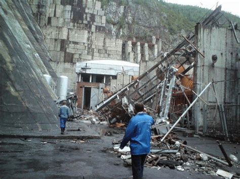

You asked about the time to ramp up and down on a hydro plant.
The limit is the inertia of the moving water in the penstocks.
Depending on the size and length, there may be hundreds of tons to thousands of tons of moving water in the penstock.
Greater output demands higher flow which means the water must be accelerated.
Ramping down too rapidly can and has been catastrophic.

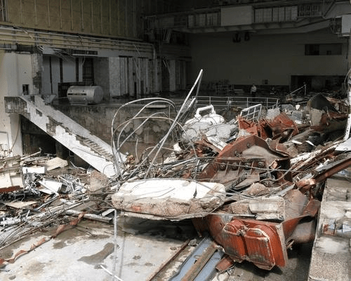

The largest hydro-electric plant in Russia.
August 2009;
This was initially reported as a transfoormer explosion.
When more information became available, it was disclosed that the gates had been closed too quickly.
The resulting water hammer broke a penstock.
The flood of water destroyed at least one generator.
Then the transformer exploded.
Scroll down for more pictures

That's only 2m/sec BI. How fast did it close?
Must have been something other than surge?
But yes, you can get very high pressures if you stop a moving pipeline too fast

I just knew you'd ask about that. Turned out that somebody closed the valve on the tanker first. That spiked me at the meter station with around 800 psi. I figured that wasn't good, whatever it was, so I closed off and told the 4 pump stations to shut down too. All those transients, must have been a bunch of column separations, plus around a thousand meters of head coming down the last mountain range made for a rough ride. It sware it was 30m before things finally got quiet again. They had just repaired the relief tank, someone put the vacuum breaker in upside down and draining the hydrotest water collapsed the top at the rim and when they left that evening, after 3 days cleaning the tank spic and span, they told me not to get the tank dirty. They were going to do the final inspection in the morning. That got delayed.
