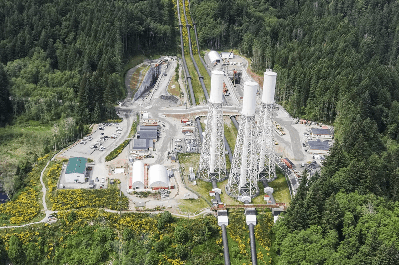

Hydro plants and water hammer.
The Russian plant had a timed closing that had been disabled or bypassed for some reason.
I have seen designs for Pelton wheels where the first action of the governor was to swing a diverter in front of the nozzle to divert some flow away from the bucket wheel. As the valve was slowly closed, the diverter would retract.
Some plants use surge towers and surge tanks to dissipate the kinetic energy of the moving water column.
