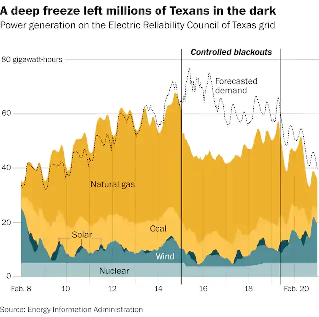

My understanding (I could be mistaken about this), is that emissions criteria was waived to allow every last kWh to be squeezed out.
As I understand it, the Biden administration's EPA refused to waive existing NOX emission restrictions, which would have permitted the CT's to "overrev" (go hotter than optimum for NOX emission levels) and so produce many percent points higher power. 200 Meg CT being able to generate 225, for example, maybe 230. The higher gas turbine outlet temperatures then create higher combined cycle steam pressures and temperatures with no increase in fuel flow. That change in exhaust gas temperature will also generate more power from the steam turbine side of the power plants.
But losing gas line pressure shuts the CT down. And no electric power shuts the house gas heating down because of no fan power.
BUT! Mid and South Texas - the regions most affected ARE NOT WINTER CLIMATES. I grew up there (San Antonio, Houston, Bastrop, Austin, Medina and Medina Valley, the Hill Country.) Spring through late fall require air conditioning now, required fans and open windows back then. High electric bills are the killer down in that region, because high electric bills are a every-day trouble for 9 months every year.
Heat protection in that region and heat-tracing wires and steam/water sensing line protection against a once-in-a-hundred-year freezing event is required, well, frankly, once in every hundred years.
North Texas? Already heat-traced.
The Valley and far south Texas? Didn't need it. Doesn't need it any more than Hawaii needs it.

Perhaps i get some of the details wrong, but the effective result is that the way the entire system Generation, Transmission, Market, reliability, and so on works in Texas is different from the way it works elsewhere in the US. And of course Europe.
A search of FERC's site for documents related to texasRE indicates some audit activity, but the documents are sufficiently redacted that it is not possible to understand either findings or actions taken. I guess that is all ruled proprietary.
I am not saying that the Texas system is better or worse than elsewhere. I pay more for power than Texans do. I think I get good value for my utility bill. Others come to a different conclusion. If enough Texans want the rules in Texas to favor lower peak prices, and higher reliability, they can have Texas's market rules changed to value those factors over the lowest possible rates.
My old man, chief metalurgist at Cameron Iron Works, used to say he could make a titanium blow out preventor, but nobody could afford to buy it.
The question now becomes, is it worth it to extend the capability of the system to cover these events. Are these events more frequent or more severe than before? How many people and businesses are being affected and how badly? Will it change the definition of the region's design storm event scale. And if there will be building code changes as a result. I believe Katrina forced some rethinking of the definition of the 100yr wave in the Gulf of Mexico, the height of storm surges and flood risk along the coast. Not sure if design wind loads changed or not.
The cost to the TX economy from Winter of Feb 2021 is already being estimated to be more than the $20 B of Katrina. That amounted to $700 PP (pop TX).

I don't think you are grasping how much of the electrical system is deregulated in the U.S. More people in the U.S. live in deregulated markets than regulated markets. The Texas Interconnect follows NERC rules and operates mostly with a few exceptions around San Antonio and Austin with deregulated markets.
If you asked me what make the Texas Interconnect different, the only thing I could tell you is that it is a an interconnect created by and for a state. I don't particularly think this is a good thing from a reliability point of view but it is a interconnect with about 76 GW of load. It has day ahead markets and nodal pricing just like MISO. I am failing to see what is so radically different. Nobody really says what is different and it starts feeling like a phantom reason. In fact, if you were to ask me what region is much different than any other it would be PJM in the eastern interconnect. They are ,in my opinion at least, the most proactive ISO. Much of what gets adopted by other ISOs started in PJm.
Map of states with deregulated electrical markets
What is different is that it is HUGE.
TWICE the capacity of #2 California.
Who's really capable of backing it up?
Its 1500 km Austin to Hoover Dam and 1200km to TVA territory.
Distance from and capacity of other significant potential resources is undoubtedly the greatest factor in why it is independent.
Twice that capacity of California which has 40% more people to supply than Texas.

The gulf coast along Texas and Louisiana is the industrial center fo the U.S. That is why its load is disproportionate to its population. You literally have miles of refineries and chemical plants. There isn't any place in the U.S. and I suspect possibly the world that is as dense with industry. It is pretty eye opening the first time you see it. The electrical grid in the Houston area itself is pretty odd for a metro due to how much load it has for its area and population. It is very strong and compact for the load it serves.
[Texas has]Twice that capacity of California which has 40% more people to supply than Texas]
Wow. I live here and I didn't realize that, although I agree with Fischstabchen the miles and miles of refinery related industry at certain points along the coast are hard to miss.
I was impressed with the reported scale of power usage at the LNG export project in Freeport TX about 15 miles from my home:
...sizable new load from the LNG export facility expected to start service in 2018.
The 656MW increase in power demand from the facility is the equivalent of the projected load growth for all of New England in the next three years. The projected load equals the consumption of 328,000 new Texas homes during mild weather.
(2B)+(2B)' ?
I understand there is tremendous industrial demand. But do all of those processes take priority over human lives? Would declaring a state of emergency had helped with the problem?
