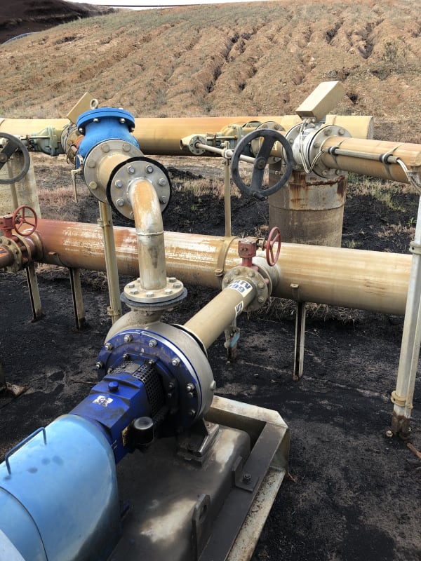

Hello All,
I’m a little stumped the following… any able to offer any insight?
Normal Operating conditions 2x pumps in parallel. Third pump kicks in on level control. When third pump kicks in its flow/current in the middle pump (pump 2) is significantly lower.
Pump 1 & 3 = 40L/s @120A
Pump 2 = 30L/s @100A
If pump 2 is operating under duty conditions it is inline with the other pump (maybe 1-2L/s lower)
I've attached a section view of the pump station, my thoughts is that it needs an inspections to wear ect but I've been told that its always happenened (even other pump i.e. 1 or 3 were doing the same).

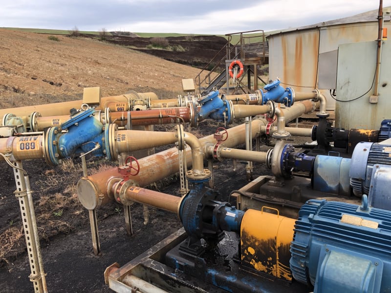

Just added a couple more of photos.

For interest, is pump 2 the same model as 1 & 3, different bearing frame and appears to have a different volute, although not really clear
And what exactly are those large blue valves in the discharge line?
Look suspiciously like pressure or flow regulating valves to me ...
If pump 2 is new, even if supposed to be the same model, it rarely is to any level of accuracy.
Same issue applies with those gate valves.
Placing them horizontal is never a great idea and it doesn't look like you can easily judge how open they are.
Hi all, to confirm a couple of comments.
The butterfly valves on the suction side are all operational - doesn’t seem there is any obstructions.
The gate valves on the discharge side are all fully opened.
The valves that look like flow regulating valves are NRVs.
