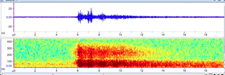

I haven't found a decent quality sound file of this, but they have at least run a spectrogram, showing alot of activity 0-100 Hz and around 230 Hz, the latter having a wavelength of 6.5m, similar to the length of the hull at 6.7m. I suspect higher harmonics might give some more clues.

Here's a wav file, and a better plot of the waveform. I don't know if the clipping is an artefact of the mp4 to wav converter I used, but this is pretty dodgy looking timehistory, the jumps in amplitude at 7 and 22s are suspicious. Comparing it with the time history in the video I'm tempted to say it's a rubbish conversion.

Well, the problem is the released mp4 file has the jumps in gain, and clipping, the displayed waveform in the first post is NOT of the audio in the mp4. That's rather annoying.

Yes. the trick would be to do a wavelet analysis, but given the rubbish quality of the mp4 audio (clipped and gain fiddled with) I'm not going to be bothering with any great enthusiasm (and alright I'm not having any success with downloading the signal analysis package for Octave).
