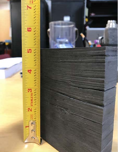

I think that describes my opinion of Rush to a T; he absolutely disdainfully dismissed all the experts that told him he was full of crap and needed to prove his concept with test to failure. His dogged pursuit of "breaking" rules, because he failed to recognize that while advances often came from breaking the rules, arbitrarily breaking the rules often does not confer advances, merely death or dismemberment.
TTFN (ta ta for now)
From the Quality Inspection report, showing the hull laminate "quality":
Just horrible.
Holy Moly!
