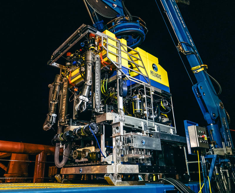

"I haven't seen anything on how these pieces are brought to the surface. ROV's? Lift bags? Crane with 2 1/2 miles of wire?"
The ROV's used to find it were tether-operated, I thought, so presumably, grab a piece and hoist both together>
The recovered debris has been dissembled and cut, when you look closely. Bolts missing, frame pieces cut. Nothing is bent or mangled.
No sign of any carbon fiber hull pieces. Missing is the titanium rear end bell and ring. I'm not sure how heavy that would be, but likely the ROV attaches lifting cables? ROV used Odysseus 6K
