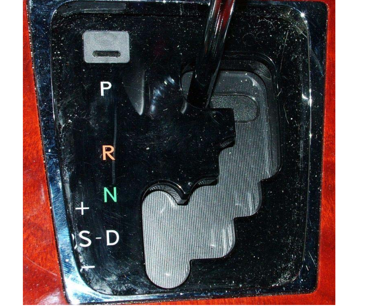

3DDave - Not sure where I saw that, but it must have seemed reputable or I might not have logged it. Perhaps it's wrong. More than likely, as I said, it boiled down to cockpit resource management (CRM) in an unfamiliar vehicle.
Take a look at this shift gate and tell me where neutral is. Now imagine trying to figure that out at 110 MPH in traffic with everyone in the car freaking out.
Another thing to consider with regards to braking, is that at wide open throttle you only get a few pumps on the pedal before the boost is gone and you're left with manual braking. Though it was clearly documented in this lexus that the brakes were thoroughly cooked. Sad story all around. Especially considering that the officer was made out by some to be at fault due to his perceived incompetence.
I guess the moral of the story, perhaps as we may even find in this train wreck, is that all of this complexity we are building into things (push button start, trick automatic transmissions, POWER!) is causing CRM issues.
