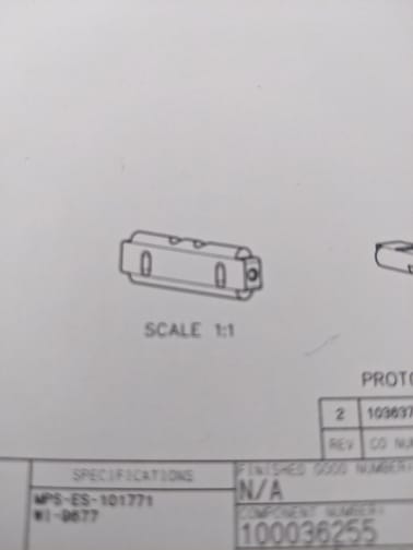

Datum feature C is derived from two cylinders . This is what what confusing to me . As i thought maybe Datum C was a derived mid axis between the two cylinders rather than a plane ?
Yes sorry this in an incomplete drawing and quick sketch , as my main focus was Datum C.
The detail on the right , again was just a quick sketch of the plan view , again as these are cylinders not planes ( apologies on the poor sketch )
I had the same question of Datum B , which is a CF
See attache Picture to get a clear understand of shape. Datum feature is with my take the mid axis derived between the two out side Radii.

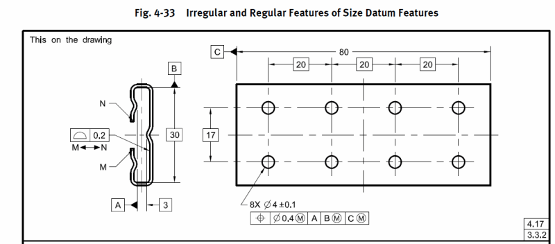

The standard specifies that the datum feature simulator shall of the inverse shape of the datum feature unless otherwise specified. Therefore I would conclude in this case that it should be two internal half-cylinders with adjustable spacing that you can reduce until contact is made with the external half cylinders of the datum feature. The datums I would associate with it are a plane that passes through the two axes of the internal half cylinders of the datum feature simulator (call it datum plane (1)) and another plane (2) perpendicular to the first at the middle of the distance between the axes. The positional tolerance referencing C can control the centering of the 5.9 width feature to plane (1).
To problem is that there is no basic geometry (true profile) to the two 2.95 (5.9/2) radii and it can be argued that the 2 half-cylinders of the datum feature simulator should be also adjustable at size, not just at separation. I'm interested to read what the others here think. This is not a simple or typical case.
Unless I missed something and some other application of the datum feature symbol was suggested, I would have to disagree - this is not the way it is drawn. As JP noted, but was omitted in the discussion following, is that the datum feature symbol applied to the 15+/-0.1 width suggests only a width shaped datum feature and simulator, ie: it would be simulated by two parallel planes contracting upon the opposed half-cylinders. If that is not the intent, the drawing needs to be changed - for example a 2X profile tolerance applied to the pair of radii and a datum feature symbol applied to the profile tolerance.
A width-shaped datum feature, besides possibly not being the intent, would make a very poor primary datum feature - as it is referenced in the OP drawing. It would be a very unstable datum feature and your parallel plane simulators would have a tendency to contract without limit (ie: no minimum). I showed this in an old thread ( my post on 18 Mar 19 16:54) - my intent in that thread was to show such a result from extreme deviation from a nominally flat surface however the same behavior would result from the case in question.

This (parallel planes datum feature simulator contacting the high points on the half-cylinders) was my initial thought too, but please refer to para. 4.5 in ASME Y14.5-2009:
"4.5 DATUM FEATURE SIMULATOR
A datum feature simulator, as defined in para. 1.3.17, shall be the inverse shape of the datum feature, unless othrwise specified. See Figs. 4-10, 4-11, 4-12, 4-13, and 4-14."
Unless this changed in the 2018 standard (which the OP mentioned using in another thread) the definition in the standard applies. Since the feature is not parallel surfaces width-type feature but two radii (could be considered as "two opposed parallel elements" regular feature of size), the datum feature simulator shall be of the inverse shape of the feature, and though we are used to seeing directly toleranced dimensions applied either to cylindrical or width-type features, nothing in the standard defines that a directly toleranced dimension always imposes the use of parallel planes (or cylinder) datum feature simulator. Rather the shape of the datum feature simulator is decided by the shape of the datum feature, not by the type of dimension given.
It was also confirmed further down the thread that the scheme shown in the drawing is not recommended and a profile of a surface specification for the radii was suggested instead, in combination with the 5.9 width selected as a primary datum feature reference for the profile control, to achieve the type of radii-to-width "centering" intended by the designer when applying the position control being discussed.
I am aware of the wording of 4.5 - this is not the way the datum feature symbol is applied or what the wording suggests. It has nothing (or at least very little) to do with the way the tolerances are applied (though none are shown in the sketch applied to the radii besides the width dimension) -* the datum feature symbol is applied to the width, therefore your datum feature is the width and the datum feature simulator is width-shaped.
See Y14.5-2009 fig 4-33 datum feature A.
*Edit: I decided to strike this portion. I should clarify, it is not dictated purely by the way the tolerances are applied, but by the way the datum feature symbol is applied to the tolerances. Sort of a nuanced distinction to make I know but let me be perfectly clear - it would not matter if the width were basic or directly toleranced, either way if the datum feature symbol is applied to the width as shown it would imply the simulator is width-shaped.
I'm used to thinking that the datum feature symbol is applied to features, not to tolerances. It is usually associated with the size dimension for features of size.
Either basic or directly toleranced - so what matters is not how it's applied "to the tolerances" is it? Then is it just the datum feature being associated with a size linear dimension that makes the simulator be two parallel planes? And para. 4.5 - it does not apply to features of size (other than when it's associated with a profile tolerance for the irregular ones)?
I can't see how the wording of 4.5 can suggest anything other than what it explicitly states.
