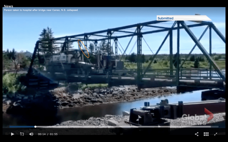

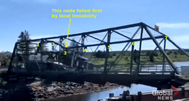

Image below is as close as I could get on my laptop to the first frame of video showing movement.
Initial failure in the circled tension member?
Both vertical members on either side of my circle move between this frame and the preceding one - the top chord/vertical member joint to the left moves up initially, while the top chord/vertical member joint to the right moves down.

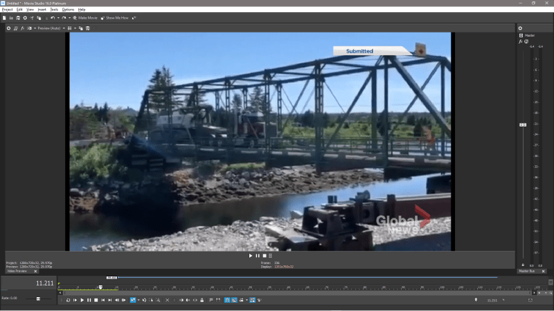

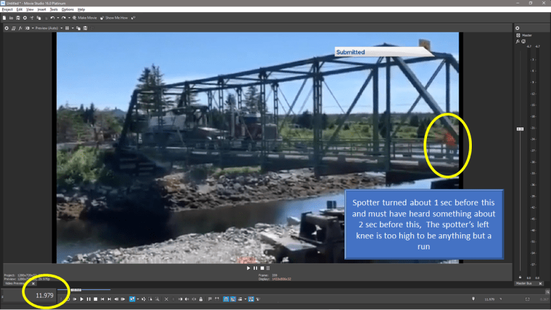

Whatever triggered that happened 3 seconds before this frame, roughly at 11.2 seconds, since that's when the front spotter turned away from the truck and hotfooted off the bridge. By the way, that particular video is relatively high quality and downloable. I was able to load it into Movie Studio and step through the frames.

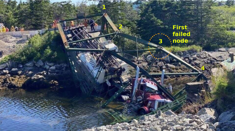

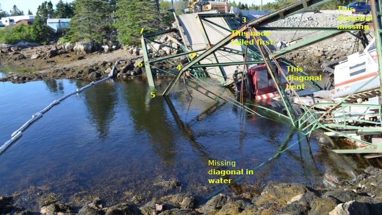

After going through the information available from the Internet this is my interpretation of the collapse.
I label the top chord of the eastern truss frame from north to south with node 1 to 7.
The Node 3 appears to fail first.

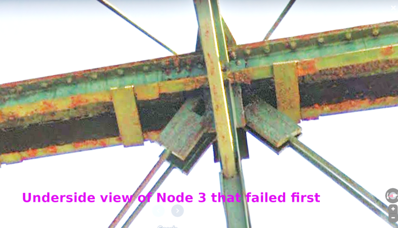

The condition of Node 3 from Google Street View looks like this (with colour brightened up). The top chord appears to be a continuous beam in permanent compression (strut). It looks like a made-up section with gusset plates welded at regular intervals to shorten the effective length to control the buckling. If the top chord were subjected to compression higher than the design capacity the made-up member could twist and buckle.
The eastern truss frame after the collapse with Node 5 submerged below the water, viewing from the northern shore.

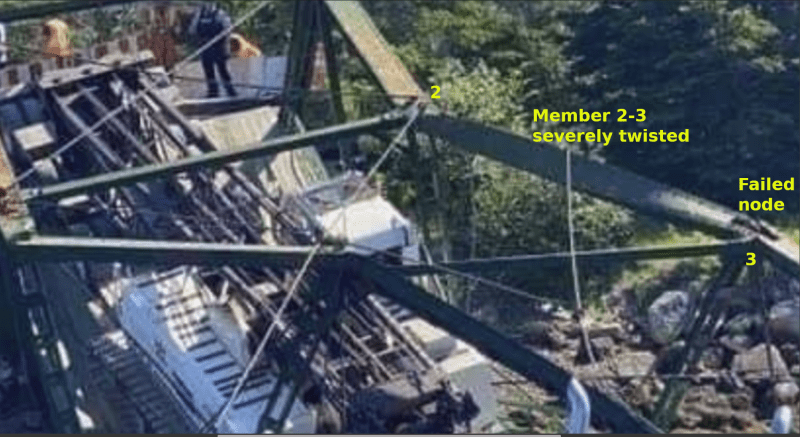

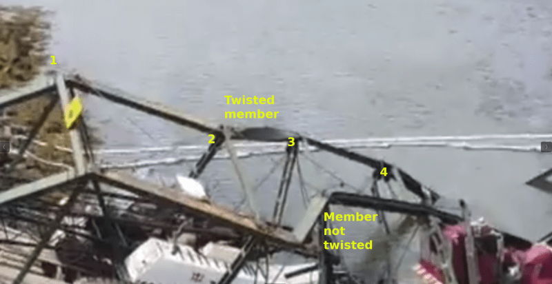

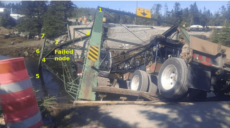

An bird's eye view of the collapsed bridge from the west approach. Member 2-3 can be seen severely twisted while the corresponding member on the opposite western side remained plane and straight.
View of the collapse bridge from the southern shore and a close up view of the buckled/twisted member between node 2 and 3.
Note that the spotter turned to run from the bridge nearly 3 seconds before node 3 visibly deforms, so they heard something almost a second before that. I think something else broke, loudly.
