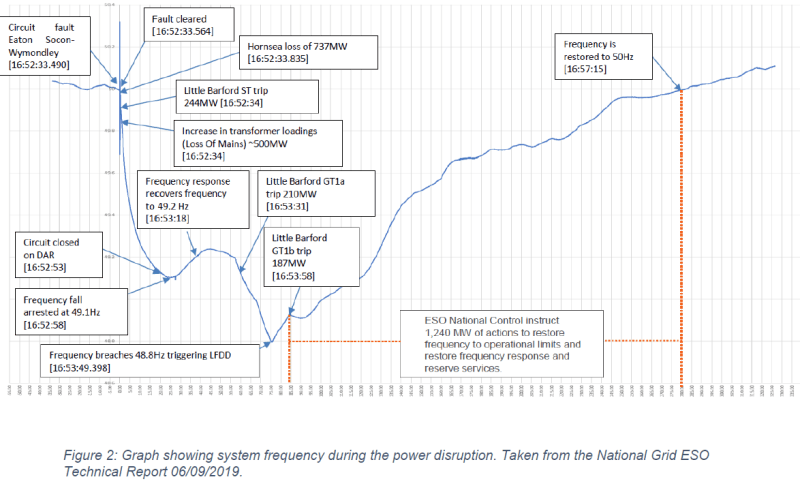

The BBC is reporting widespread blackouts in London and the SE and I can see that a lot of emergency generation has started up (suggesting low frequency cut in). It'll be interesting to hear what happened and how low the frequency got. This is at least the 4th low frequency event so far this year.
Does anyone know any more details?

Thanks Hoxton. The findings are interesting and lots of learnings for utilities all over the world.
Good, comprehensive report produced in a short time of a month.
After our August 9th power outage the government discovered that it had an 'Energy Emergencies Executive Committee'
Government was so exited that it asked them to report! Sorry for cynicism!
Herewith report
 https://files.engineering.com/getfile.aspx?folder=62b701e6-6cec-4377-b3b5-e2a490387781&file=20191003_E3C_Interim_Report_into_GB_Power_Disruption.pdf
Sounds like the substation level Low Frequency Demand Disconnection feature did not work very well. I wonder if it is time to move LFDD/(UFLS) function down to individual "smart" devices? It would be kind of interesting to have my TV shut down at 49.3 Hz, my refrigerator stop at 49.2 Hz, and my computer to shut down at 49.1 Hz.
Even better, my LED lights might ramp from 100% brightness at 49.5 Hz down to 10% brightness at 48.8 Hz. My VFD driven residential HVAC system could also have a linear ramp down of consumption. Setting the triggering threshold for linear ramping of lighting and residential HVAC systems above the first substation level LFDD/UFLS of 48.8 Hz might arrest frequency before resorting to tripping substations.
From Figure 2 in the report, it looks like amount of load tripped at exactly 48.8 Hz may have exceeded the amount of load needed to stabilize the system frequency. In the UK LFDD program, are there additional time delayed blocks? Within the western USA, there are additional small anti-stalling blocks disconnected at 15, 30 and 60 seconds.
As pumps and fans are moved behind VFDs, the grid looses both inertia and the load reduction frequency response characteristics of lower load at lower speeds during frequency depressions. Any idea what portion of VFD applications could be programmed with a frequency response for input frequencies lower than 49.5 Hz?

In response to bacon4life's question. See attached from one of our DNO's. Table one gives the LFDD structure for one DNO.
There is no phased application of this, ie time delays within each tranche.
"The LFDD relays are fitted at 132 kV substations and are designed to trip the lower voltage side of the incoming 132 kV transformers or some or all of the outgoing feeders."
I assume that this means that the LFDD relays operate to trip the outgoing 66 kv or 33 kv feeders.
Apparently there is a review system so that hospitals and other significant infrastructure is not affected.
What is apparent that there has been no assessment of the positioning or power effect of distributed generation. It seems that LFDD could have tripped feeders that were actually sending power to the 132 kv system, which hardly helps!
One other effect that caused major transport disruption was the software upgrade to some electric trains which ensured that the trains tripped and locked out, such that the driver could not reset the train.
 https://files.engineering.com/getfile.aspx?folder=c58beb2b-17e4-49bb-9415-faba2548c241&file=6-Low-Frequency-Demand-Disconnection_(5).pdf

yes it is, but the links are Dc and converter-fed at both ends. This essentially isolates one system from the other in terms of providing inertia (rotating mass) to slow the rate of frequency change. The principle reason is that the losses for long cables are very high.

3) Hornsea Windfarm trip
This seems to have been some form of software issue, now corrected...
4) Stop Press
A Mandatory retrospective change to UK 'G59' settings is being imposed for sub 5 MW sets, the larger sets having already had their settings changed.
I reckon Hoxton sorted this in the last sentence of his last post.
I've got a sub 5MW generator sync-ced to the mains at 11kV and having run for many years quite happily has tripped several times in about 2 months due to ROCOF.
The ROCOF discussions are well buried but they are there to be found and it seems the powers that be realised they were sitting on a potentially serious problem some while ago and revisited G59.
Sub 5MW has just been addressed and the ink is still wet on the signatures.
Seems to be the lack of system inertia, how much inertia does a wind turbine and inverter have, is failing to prevent the voltage and frequency drop, our machines try to catch up but the rate of change is such they come out on protection.
