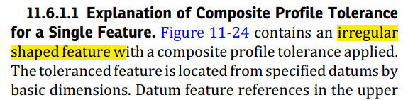

At para 11.6.1.1 in Y14.5-2018 clearly states irregular shaped feature, a round hole in this example is just a regular FOS.

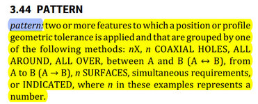

There is an all around symbol used in the example of Figure 11-24, according to the para 3.44, this is a pattern features, a single hole is not a pattern.
I still think a single round hole can not use composite profile callout based on the reasons shown above.

The standard acknowlesges that composite profile can apply to a single feature which is not any kind of a pattern. That's why instead of P(attern)LTZF and FRTZF the description in the relevant section involves "profile-locating tolerance zone" and the "profile
feature tolerance zone" in the context of single features (look them up in your copy of Y14.5).
