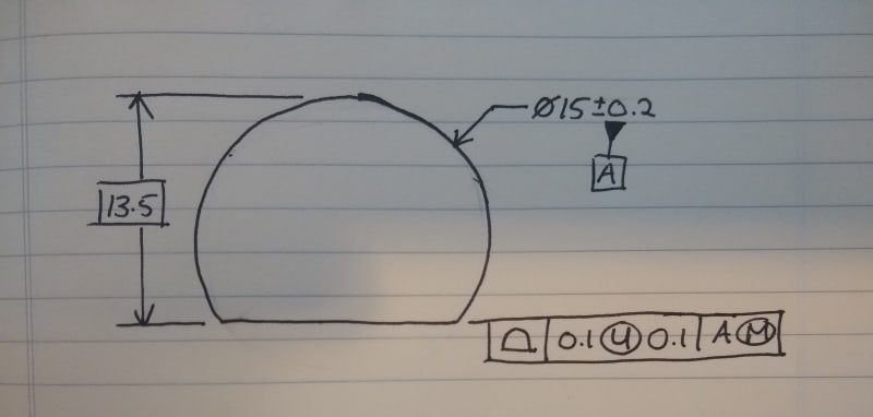

Curious about the interpretation of the unilateral tolerance zone in the following example. As A departs from MMC, does the bonus tolerance applied to the profile control now allow for removal of material, or is the implied 'outside only' condition preserved, ie. would the implied profile callout at a diameter of 14.8 be |0.5 U 0.1| or |0.5 U 0.5|?
Or perhaps the better question - is this even a valid callout?
Datum feature A establishes an axis - wouldn't the basic dimension be drawn from the center of A? Well, technically, from the center of the true geometric counterpart of A at 15.2?
Good point. I guess the question about bonus tolerance still applies though.
Since the feature is not located to datum feature A it's not a valid call out.
Had the dimension been to the datum feature axis it would work as imagined by creating a gage that has a partial 15.2 diameter boundary with a scribe line that is some value, whatever it is supposed to be, from the center of the diameter to where the flat is and another that is 0.1 farther than that. Drop the part in the gage and as long as it can be manipulated so the flat lies between the two lines and is not smaller than 14.8 diameter, it passes.
If the basic was drawn from the center of datum feature A, then what the callout is establishing is a planar tolerance zone of width 0.1 starting at the noted basic dimension and extending outward. The MMB modifier on datum feature A should do nothing to modify your tolerance value internally or externally. The only purpose of the modifier would be for some added mobility when A departs from MMC size.
For example, let's assume the planar surface is meant to be 13.5 BASIC from the center of A. Let's assume that it measures at 13.7 - it's too far away. As datum feature A departs from MMC, it can translate/rotate within it's true geometric counterpart (of MMC size) until the planar surface is located back in the tolerance zone described above.
Side note - profile tolerances are always applied RFS. The (M) in conjunction with the datum feature callout is a Material Boundary Modifier which denotes Maximum Material Boundary (MMB) for datum feature A. This allows datum feature shift (the behavior that Jacob described), and is NOT a bonus tolerance - though it might look like one in some cases.
It is a valid call-out as is. The profile call-out is controlling the position wrt A, orientation (parallelism) wrt A, and form (flatness) of that flat surface.
There is no bonus tolerance. The (M) after A indicates MMB (datum shift), which would allow the inspector to shift (translate and/or rotate/tilt) the part in order to bring it in spec., if possible (depending on the measured size of datum feature A). The fixed size of the datum A simulator (gage) would be 15.2. For example, if the part was made at dia 15, then you would have 15.2 - 15 = 0.2 (0.1 mm radially) play.

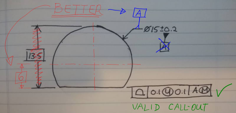

The profile callout itself is valid but, as mentioned by others, the basic dimension is defined incorrectly. See fig. 4-30 in Y14.5-2009 or figs. 7-32 and 7-33 in Y14.5-2018.
Tarator,
Basic 6 is not just better over 13.5. Basic 13.5 is simply incorrect.

Parts are dimensioned from the DRF. The basic dimension is a theoretically perfect dimension and it certainly shouldn't depend upon the size of the datum feature. If it is drawn from the edge of the datum feature, it is directly effected by the size. As the datum feature A gets smaller, what happens to that basic dimension? Does it stay the same? Does it get smaller? What does that mean for the toleranced surface?
The idea is that the surface isn't dimensioned to the datum feature, but rather the MMB of the datum feature. The MMB will be "perfect" so if you wanted to add the radius of the simulator to your measurement and measure it as such, I assume that you can. As far as the drawing is concerned, however, I believe your basic should come from the center of A to avoid any ambiguity as I mentioned above.

Unfortunately it does matter. As is, the profile callout basically defines a tolerance zone relative to a datum derived from datum feature A simulated at MMB. Therefore, there needs to be a basic distance between the datum and the tolerance zone/true profile, otherwise the entire specification is incorrect. There would be no issue if the diameter of datum feature A was basic, but that is not the case as we all can see.

So I will ignore greenimi and go back to the original sketch/drawing, maybe this time from a different view of angle:
Imagine you have the 3D model opened up in your CAD package. And all you see is a size dimension with tolerances (dia 15 ± 0.2), no basic dimensions at all. And you like to know the distance between the planar feature and the center of the cylinder. You use the measurement tool in your software and measure the distance from the planar face to the edge of the cylinder as 13.5 (in this scenario, it is more convenient). Then you would calculate 13.5 - 15/2 = 6. Would that be wrong? Why can't you do it in a 2D drawing? If there was no nominal value, then, of course, you wouldn't be able to do that.
All I am saying is that it is not the ideal way to dimension that feature from the edge of the cylinder. I would do it from the center. But in my opinion, it is not incorrect to dimension it from the edge.
