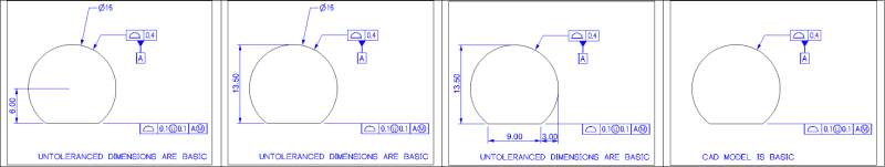

Curious about the interpretation of the unilateral tolerance zone in the following example. As A departs from MMC, does the bonus tolerance applied to the profile control now allow for removal of material, or is the implied 'outside only' condition preserved, ie. would the implied profile callout at a diameter of 14.8 be |0.5 U 0.1| or |0.5 U 0.5|?
Or perhaps the better question - is this even a valid callout?

I think the original question of the OP (about the effect of MMB on the unilateral tolerance) got overlooked in the argument over dimensioning. Had the 13.5 basic been replaced by basic 6 from datum axis A, a feature produced with the flat offset less than 6 from the axis of datum feature A could indeed be approved due to datum shift.

I agree that the correct answer shouldn't be determined by how many people have said it, or who they are. If Tec-Ease or pmarc or myself gives an opinion about a GD&T topic, that doesn't mean that it's absolutely correct. It just means that it's most likely correct ;^).
Here are other cases to consider, that may shed some light on the situation. What basic dimension (for the distance between the OD extremity and the flat) would be valid if:
1. the OD had been modeled at 15.2 and toleranced with the equal bilateral tolerance of 15.0 +/- 0.2?
2. the OD had been modeled at 15.2 and toleranced with a unilateral size tolerance of 15.2 -0.4 +0 ?
3. the OD had been modeled at 15.5 and toleranced with a minus-minus size tolerance of 15.5 -0.7 -0.3 ?
4. the OD had been modeled at 15.1 and toleranced with a limit tolerance of 14.8 - 15.2 ?
5. the OD had been modeled at 15.0 and toleranced with a datumless profile tolerance of 0.4?
6. the OD had been modeled at 15.2 and toleranced with a datumless profile tolerance of 0.4?
I'm interested to hear how everyone would answer these.

The way you posed the question, none of them would be valid because the root of your question still keeps the basic dimension "between the OD extremity and the flat."
Since your question merely changed how the OD size is given, but hasn't changed the way datum feature A is labeled, then the basic dim shall still come from the center of the OD, not its 12 o'clock extremity.

There are places where the standard is unclear and can be subject to more than one interpretation and extensions, and there are places where the standard is crystal clear and there should be no personal interpretations. Otherwise, we don't need the standard and everyone is free to put on their drawings whatever they want and then engage in endless debates and arguments over what drawings mean. I tried to encourage you to investigate and find out yourself that the Y14.5 standard clearly specifies that a true profile of a feature is defined either by basic dimensions or by the CAD model (where there is an appropriate note on the drawing and no other specification):
"A true profile is a profile defined by basic radii, basic angular dimensions, basic coordinate dimensions, basic size
dimensions, undimensioned drawings, formulas, or mathematical data, including design models."
- para. 8.2 in the 2009 version.
Note that nominal values of +/- dimensions are not part of it.
If you don't care about what the standard has to say think of the person who will put the 13.5 basic from the edge of the cylinder on his drawing with the 15+/-0.2 diameter datum feature, thinking it means the same thing as 6 basic from the datum axis, and eventually will end up arguing with a vendor that will be saying that parts that were produced out of tolerance when checked to the DRF are in spec, and as proof will be showing how he measures the distance from the edge of the cylinder to the flat, getting the right numbers.
The OP's question was clearly about how to read and interpret the DRAWING. If someone wants to blur the lines and mix some terms from model based definition that is another story (how to model the part, which is the nominal dimension on the model--perfect part modeled, what and how to measure the model, etc.) ASME Y14.41 (Digital Product Definition Data Practices) might have some good suggestions, however not complete and maybe should be supplemented with some company's internal standards on modelling. But again, that was NOT part of the OP's question, as far as I am concern.

I agree with J-P, the way you asked the question (what basic dimension would be valid...?) 1, 2, 3 and 4: none.
On 5 and 6 I would like more details, datumless profile applied to the OD? and then would you remove the ± (15±0.2)?
greenimi,
Sorry, I wasn't clear about the datumless profile. That was meant as a replacement - the directly toleranced 15 +/- 0.2 size dimension would be removed.

I was thinking that there might be another way that we could show that if the OD was controlled with a directly toleranced size dimension, then a basic dimension between the extremity and the flat would not be valid. I was also thinking that if the OD was controlled with datumless profile instead of a directly toleranced dimension, then that would change things.
Evan Janeshewski
Evan -- so you're not trying to show any way that the basic dim given in the OP could be valid. You're trying to redimension the OD in a way to clarify why the basic dim given in the OP is never valid?
Honestly, I think you're overcomplicating it. It boils down to this: As long as the datum feature symbol stays where it is, that means that the datum is the axis, and thus, the basic dim must originate from the axis (para. 11.6.1.1, "The toleranced feature is located from specified datums by basic dimensions" -- they say this regarding composite profile, but it applies to regular profile as well).

There would be no issue if the diameter of datum feature A was basic,
Looks like no matter how we are spinning it the current specification is plain wrong.
I think the last couple of posts mesh on the same idea, and so then I would agree -- thanks for clarifying.
If the OD is basic, then we would have the basic dim that I was lobbying for because it would be a chain of basic dims from from the axis (a radius), but by way of the basic OD.

J-P,
Yes, I'm trying to objectively show that if the OD has a directly toleranced size dimension then the basic dimension is never valid. Sorry it got so complicated.
If the OD has the datumless profile instead of the directly toleranced size dimension, then I would say that any basic dimensioning scheme is valid and equivalent:
We don't necessarily have the basic dimension that you are lobbying for. Would you agree?
Evan Janeshewski
We do have the basic I was lobbying for. Though not directly labeled, it's a chain of basics: from the profiled flat surface back to the 12 o'clock tangent point of 13.5 mm, and then an implied basic of 7.5 mm.

J-P,
The way I look at it, the presence or absence of an explicit basic dimension makes no difference to the meaning of the specification (if a CAD model is referenced). In other words, the basic dimensions are all there in the CAD whether they are explicitly annotated or not. If a directly toleranced dimension is specified, then that changes things - the feature is no longer theoretically exact. I agree with the opinion that mixing directly toleranced dimensions and profile tolerancing is problematic. I know that Y14.5 has examples that do this, but I wish that these would be eliminated.
So I guess that the question about the validity of the basic dimension comes down to this:
I believe this is how Y14.5 currently works.
