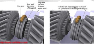

As I stated, the rotor is fully locked with the wheel when the system is engaged. Doesn't matter if you're going in reverse or not. Think of a dog gear teeth on a gear, (one set on the rotor and other set on the wheel hub) ignore the synchros for now:

Engaging what is effectively a dog clutch when there is a large difference in rotational speed between them, breaks stuff.
