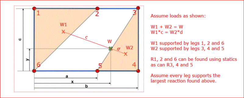

Hi Everyone,
I have a structure supported by six legs that are bolted to the floor. The top view of this setup is shown below. The center of gravity of this structure is marked with a green X, the fixed support legs are shown with red points. I would like to work out the force exerted on the floor by each leg.
x is bigger than a but smaller than b.
What is the best way to approach this problem?
I have tried to derive an equation for this but as you can guess, I didn't have any luck.
I understand that I could go down on the FEA route but what I would like to get out this is an equation system that I can use in Excel when the numbers change.
Many thanks for your help.

I do not believe there is any general solution to your problem. The answers will depend on the exact loads applied at exact locations and to the exact stiffness of every part of the structure.
This problem is very similar to how do you calculate the loads in rigging when lifting large heavy objects. Levers and fulcrums are used to remove the unknowns in cable lengths structural stiffness. You cannot do that for your problem. Your answers are only as accurate as your assumptions. In this case your assumptions are not likely to be very accurate.
I'd concentrate on coming up with a conservative solution to the problem rather than numerical accuracy.

Hi, I thought I’d just contribute to the original request, namely what type of hand calc approach could be applied to the problem. These equations may be of use.
The location of the applied forces are to be given in a global coordinate system, as well as the location of the six supporting legs. The legs can be viewed as a bolt group, placed in the x,y plane. The x,y coordinates of the bolt group centre (BGC) is first found. This is based on bolt x and y distances. In addition, to represent stiffness, a weighting factor can be included (section area or shear / axial stiffness). Knowing the BGC, moments about the x, y and z axis are calculated.
To react out Mz, the assumption that each bolt reaction force is proportional to radial distance from the BGC is made. Based on this, the following is applied.
Pr(i) = Rz.r(i), i for individual bolt number.
If weighted, use Pr(i) = Rz.r(i).A(i), if area. Note that Pr(i) acts at the bolt position and is normal to the radial arm of the individual bolt.
Mz(i) = Pr(i).r(i)=Rz.A(i)r(i)^2
Applied moment Mz = Rz.Sum[A(i).r(i)^2]
Sum[A(i).r(i)^2] = Sum[A(i).[(x(i)-x’)^2+(y(i)-y’)^2]], where x’ and y’ are bolt group centre (BGC) coordinates. Rz can be found and used to find Pr(i). Components in the x and y coordinate system will be needed. The applied forces in the x and y directions are distributed to each bolt, incorporating any weighting.

There is no unique solution. It depends on the stiffness of the supported structure as well as the distribution of load, not just its center of gravity.
The solution proposed by Stress_Eng is similar to the instantaneous center method for a bolt group. In that case, there is a known moment about the BGC and the plate is properly deemed to be rigid. In the current case, Mx, My and Mz are all zero; there is no applied moment. The plate is not rigid as it can bend between supports. If it were truly rigid, why use six supports? Three would be enough, but four would make for better symmetry, one at each corner.
With three supports, reactions can be determined by statics alone. With four, assume the load is carried by three supports and make the fourth the same as the worst case (a little conservatism never hurts).

Hi, just wanted to give some food for thought, for yet another possible hand calc approach. The plate could be visualised as six springs (joined at cg and individually fixed at legs), each representing load path regions of the plate. Each will have a x and y direction spring stiffness, based on their combined axial and shear deflection capabilities. If needed, a z stiffness could be calculated, based on cantilever bending (fixed at cg) and possibly shear (short beam). A load split can be determined, based on equal x,y,z displacements.
If the only forces under consideration are gravitational, z stiffness is the only one relevant. Without some information about the stiffness of the structure being supported and the distribution of load, there can be no unique solution.

Hi, I have one other possible hand calc approach you may consider. If the structure around the plate profile is considered to give a simply supported condition, then you could consider applying the principles of rectangular plate bending theory. The approach can accommodate numerous types of loading configurations (uniform/ tapered pressure distributions, singular / numerous variably placed point loads). I would suggest referring to references such as Timoshenko. The principle would permit you to determine, under your loading condition, the distributed shear about the profile of the plate, which you could sum up between the legs, find the centroid of the load between the legs and proportion relative to distance.
You could go one step further. Permitting the plate to bend will allow the plate to shorten in length, in both the x and y directions. This change in length can be found, and used in conjunction with the leg displacement stiffnesses to determine leg attachment reaction forces in the x and y directions.

Has Mernok1 got the luxury of being able to alter the structural configuration, and reconfigure the plate structure to make the cg coincide with the BGC? If so, 4 legs would make the situation so much easier!
The original post states 6 legs are all bolted to the ground. This therefore implies that all 6 legs are active in reacting to the applied load. The post also implies that the cg is not in the centre of the plate. If the legs are of different lengths, the act of bolting them to the floor would introduce build stresses into the structure, due to forced displacements. Can shimming be introduced, to reduce any build misalignment? If manufacturing tolerances are to be included in the analysis, the forces required to displace the plate, to allow the legs to close any gaps would need to be determined. Once these forces have been derived, reactions due to applied loading would need to be superimposed.

If the legs are of different lengths, (as they are bound to be) the act of bolting them to the floor would introduce build stresses into the structure, due to forced displacements. Displacements are not forced if the structure is rigid.
Can shimming be introduced, to reduce any build misalignment? Certainly it can, but it won't be enough to permit precise calculation of the six reactions.
If manufacturing tolerances are to be included in the analysis, the forces required to displace the plate, to allow the legs to close any gaps would need to be determined. Once these forces have been derived, reactions due to applied loading would need to be superimposed. It's easier to overestimate the reactions and make all legs the same (a little conservative, but sensible).
