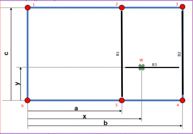

Hi Everyone,
I have a structure supported by six legs that are bolted to the floor. The top view of this setup is shown below. The center of gravity of this structure is marked with a green X, the fixed support legs are shown with red points. I would like to work out the force exerted on the floor by each leg.
x is bigger than a but smaller than b.
What is the best way to approach this problem?
I have tried to derive an equation for this but as you can guess, I didn't have any luck.
I understand that I could go down on the FEA route but what I would like to get out this is an equation system that I can use in Excel when the numbers change.
Many thanks for your help.

We know nothing about the "supported structure". If the load consists of a single concentrated load, the structure could consist of simple span beams B1, B2 and B3 as shown below. In that case, all reactions may be obtained using statics.
We know nothing about the load to the left of leg #2. If we did, a similar system of simple span beams could be used and again, we could easily determine reactions at each leg.
If we assume, as has been suggested in earlier posts, that the supported structure is a rigid body, then differences in elevation at bearing points need to be considered. The magnitude of reactions cannot be calculated without some idea of the supported structure and the distribution of load.
While it may be a useful exercise to determine each reaction, why does it matter? It seems more likely that all six legs would be identical rather than designing each for its particular reaction. Is that in dispute?

Assumptions:
1. supported structure is rigid
2. attachment points are at the same elevation
3. supported structure is braced laterally to prevent translation and rotation about vertical axis.
4. each leg is fixed at the base and either pinned, fixed or rigidly attached to the structure above.
5. each leg is precisely the same length.
6. rb1957 is on holiday, far, far away. [pipe]
Calculation:
σxy = P(1/A + y/Ix + x/Iy)
where σxy is stress at eccentricity x, y from the c.g. of leg group
A, Ix and Iy are area and moment of inertia about X and Y axis respectively for the leg group.
Rn = σxy*An where R is reaction and subscript n refers to leg number.
BA
so now when we state all the assumptions, I think we've solved it using the method in the first reply ?
or is it load is inversely proportional to distance ^2 ?
The only problem is the assumptions are unachievable, so the solution is wishful thinking.
EDIT: But who cares? It doesn't really matter a tinker's dam (whatever that is) what the reactions are, provided the legs are adequate to carry the worst case. When the worst case is not precisely known, engineering judgment must be used. Hopefully it is available

What I am envisioning from the OP's description, is six short steel columns (the "legs") carrying a structure of some kind on top. If the weight of supported structure is "W" and its c.g. lies within the rectangle enclosing the legs, the maximum reaction cannot exceed W. If the typical leg is selected to safely sustain a load of W at a specified height, that would seem to be pretty conservative and, unless W is huge, would not entail a significant cost.
The engineering cost to conduct complex calculations would far exceed any saving in material cost.
BA
You are absolutely right, we could just say each leg is designed to take the total load W. That would solve the problem.
