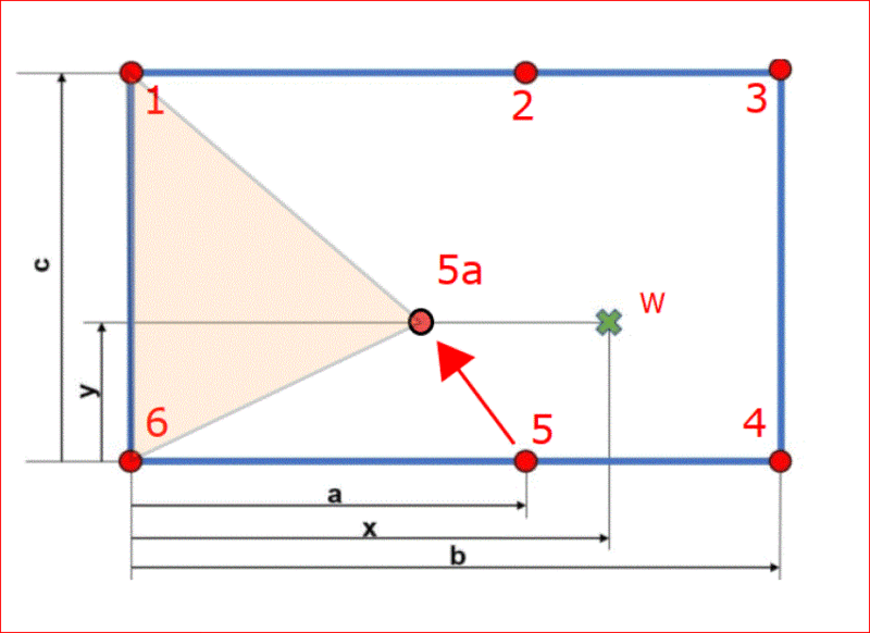

Hi Everyone,
I have a structure supported by six legs that are bolted to the floor. The top view of this setup is shown below. The center of gravity of this structure is marked with a green X, the fixed support legs are shown with red points. I would like to work out the force exerted on the floor by each leg.
x is bigger than a but smaller than b.
What is the best way to approach this problem?
I have tried to derive an equation for this but as you can guess, I didn't have any luck.
I understand that I could go down on the FEA route but what I would like to get out this is an equation system that I can use in Excel when the numbers change.
Many thanks for your help.

If the position of the c.g. shown is accurate, all that needs to be done for an acceptably conservative solution is to assume that legs 2,3, and 5 support the load, and calculate the reaction at 5. If the c.g. is at another location, the more general solution is to calculate the reactions assuming all possible combinations of 3 legs supporting the load, and use the largest reaction at any leg. That's just my 'brute force' approach.
That assumption would lead to a conservative result, but without the cooperation of the installers, the assumption could be wrong. If they install leg 4 slightly higher than leg 3, the load is carried by 2, 4 and 5.
Even worse is if they install legs 1, 2 and 6 a little higher than 3, 4 and 5 because that puts leg 1 in tension (T1) so that legs 2 and 6 are sharing a load of T1 + W. It may even be possible to find a combination where one leg carries more than W.
BA

If legs 1, 2 and 6 are installed a little higher than the other three, then the load is outside those three columns; and they are the only ones that matter. In a different arrangement of legs, it is possible to place three legs in a position such that one leg supports a load greater than W, even if the c.g. of load is inside the envelope of all columns.
BA
If leg 5 is moved to 5a, or a new leg is added, legs 1 and 6 will both be in tension while leg 5a will sustain a load greater than W, notwithstanding the fact that the c.g. of load is within the envelope of columns. In effect, the structure becomes a propped cantilever.
BA
You are correct. That is a possibility I overlooked.
rb1957 said:
"It may even be possible to find a combination where one leg carries more than W." ... no, if the load is within the envelop of the reactions then the maximum reaction is equal to the load (when the load is above one of the legs). Only if the load goes outside the envelop of the reactions can a reaction exceed W.
Incorrect. As BAretired pointed out, depending on the load location, the load on a leg could exceed 2*W. For instance, if the load is placed along the edge between 1 and 2, closer to 1, and Leg 1 is short and doesn't support any of the load, then span 2-6 becomes a back span of a cantilever.

It was never a simple problem; it really is unsolvable. With assumptions, it can be made soluble, but of what value is that if the assumptions are unrealistic? Installers cannot be assumed to be magicians.

In item 5) on your list, you cannot be certain that legs 2, 4 and 5 will carry any load at all. Perhaps legs 1, 3 and 6 carry all of the load.
Any three points in space describe a plane unless they are aligned, in which case they describe a line. If there are only three legs, three bearing points describe a plane. If there are six legs of slightly varying height, it is impossible to know which three will describe the highest plane. It could be 2, 4 and 5, but it could be any other combination (with the exception of 1, 2 and 3 or 3, 4 and 5 which align).
With six legs, the only possible combinations are as follows:
124, 125, 126, 134, 135, 136, 145, 146, 234, 235, 236, 245, 246, 345, 346, and 356.
If I haven't missed any, that is a total of 16 combinations. Any one of those could form the critical plane, leaving three legs unloaded in all 16 cases.
Discrepancies can occur due to (a) uneven level in bottom slab, (b) curvature of the bottom slab, (c)errors in length of leg, (d) workmanship errors by installers and (e) errors in fabrication of supported structure. Some errors may be compensating; others may not, but there will be some discrepancies.

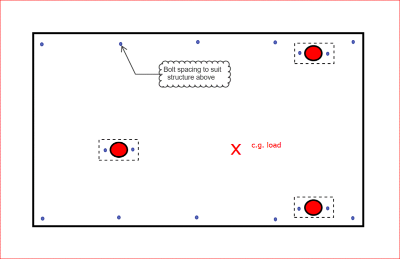

Using only three columns, each reaction can be accurately calculated, even if the workmanship is not precise.
