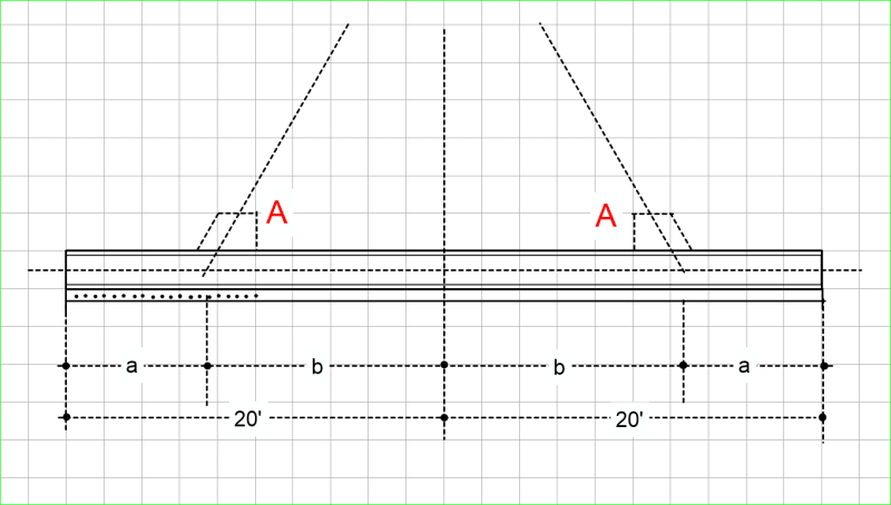

I have the below scenario: How do I resolve the force being applied to the welds given a max shear and a max moment (developed from shear-moment diagram).
The orange dots represent locations of the fillet welds. Channels are 15" deep. plate is 36" deep.
JP20, I like BA's idea of moving the lift points in - also reduces our hook height requirement on the crane. Although, your unbraced length in bending could still be 40' depending on load placement (entire beam could be in negative bending).

The choice of WF section will depend on load and span. You will probably need to comply with OSHA requirements for load factors. I am not familiar with them offhand, but I suspect they are higher than normal load factors for beam design for a building.

The part I hate most is that no matter what you do to this type of lifting device, you cannot laterally brace it. If someone knows of a way to, let me know! Otherwise I’ll be using BTH manual to design as 40’ unbraced.
If you use a span of 40', you will require a pretty hefty beam. Why don't you consider reducing the span by having a cantilever at each end? Not only do you reduce the span, but you apply a negative moment at each end which directly reduces the positive moment in the central span.
In a way, you are laterally bracing the beam at the pickup points by applying the load below the beam, preventing rotation about the beam axis. You could brace the top flange between pickup points with a top channel or plate, but it is probably more economical to select a WF which can span the central span without additional bracing.
The cables, chains or slings make an angle with the beam. They put moment and compression into the central span which needs to be taken into account.

I think you know the design criteria well, but rusty in the real design. Your 40' beam length is a problem, not only in design, but you will require ample space, and equipment that capable of handle this operation. I suggest to sort through internally to gather ideas, and refine the plan and method to carry out the task. Also, you'll be definite benefitted from engaging a structural engineer, who is familiar with the nature of your business and the task on hand. My last suggestion, for lateral stability concern, a strong box beam may work, but not for present length.
If total load plus beam weight = W
then W/2 is vertical load at each pickup point.
w = W/40
F = W/2sinA (sling force)
Pspan = W/2tanA (compression in span)
Mcant = wa2/2
Mmidspan = w(2b)2/8 - wa2/2 = w(b2 - a2)/2
If a = 8', b = 12'
Mcant = 32w
Mmidspan = 40w
If a = 10', b = 10'
Mcant = 50w
Mmidspan = 0
