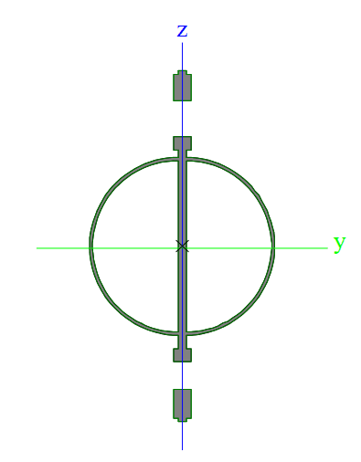

I have the below scenario: How do I resolve the force being applied to the welds given a max shear and a max moment (developed from shear-moment diagram).
The orange dots represent locations of the fillet welds. Channels are 15" deep. plate is 36" deep.

I would give some serious consideration to something like Craig's recommendation, repeated below. Not that it necessarily has to be ac circular section etc.
While it may not optimize your material costs to the nuts, one very simple way to shed the complexity involved with this stuff is to design yourself a cross section that would work for both strength and stiffness even if it did roll over in lateral torsional buckling. Flip the thing sideways and make it work that way as a beam column.
Obviously, that makes for a section with a lot of weak axis meat to it. But, then, you've got a fairly simple and reliable solution that you can execute without too much fuss.
One problem with your current section is that, with your three point support condition, sometimes the compression flange will be the bottom flange. In that case, you'll have your edge stiffening on the wrong side.

I think it is important to have a compression flange with some healthy Iy properties near to the extreme compression fiber and I don't think you get that here .
The approach that I recommended would treat the flat plate as entirely sacrificial except for local transfer of loads in and out of the system. As such, I've little concern for the Iy properties near the extreme compression fiber.
That said, I voiced a similar concern in OP's previous thread on this topic.

..your critical failure mode is likely to be out of plane plate buckling of the portions of the flat plate extended above and below the channels.
If the design assumes that the plate is to be fully utilized in flexure, I imagine that one would check this failure mode via b/t ratios or something similar. With plate extensions 1.25" thick and 8"+/- long, I don't see this being much of a problem.

My thoughts from the file uploaded earlier
Getting back to the original question, at ultimate load, each channel is stressed to Fy, compression tension on top, tension compression on the bottom. The total force in the top and bottom of the channel is Fy*A/2. That has to be developed by a weld of length L/2. If we assume uniform distribution from end to centre, the weld must carry a force per unit length of Fy*A/L where A is the area of channel and L is the span of the built-up section.

I disagree with a couple parts of this statement. First, if you look at the proportions of this beam, there is no chance that the channel flanges get to see Fy before this fails - the beam is far too flimsy to reach yield before buckling.
Further, it has been thoroughly discussed here that the development of bending stress in the channel flanges does not come from the welds - centroids of all sections align, Q = 0, no shear flow in the welds. Any bending stress developed in the flanges of these channels would come from shear flow between channel web and flange.
Kootk, I get what you were suggesting now - the bit of plate above the circular section is essentially just a continuous lug. I'd be comfortable using that bit of plate for checking the cross-section strength (healthy b/t ratio as you suggest), but for LTB checks I would assume that bit of plate doesn't exist and that top of beam = top of circular section.
BA's method is the practical method of design, the stresses create a couple on the channels, and force the channels to separate from the center plate, thus require weld to glue the pieces together.

The beam is 40' long, with 3 slings on top and multiple lift loads below. The channel wasn't sized, but an attempt to prevent buckling.
Well, if the channel size is C380x50 (C15x33.9) and the span is 20'-0" or say 6000mm, the weld must be good for 6430*300/6000 = 320N/mm which would require an intermittent weld of 6mm (not worth getting excited about).
What may be worth getting excited about, however, is the question of buckling. This needs to be properly checked to determine whether or not the proposed section is adequate for the rated capacity of the lifting beam.

I can't believe I'm still here saying this. The bending stress in the flange of the channel does not come from the weld. This is fundamentally incorrect. The centroids of all components align with the neutral axis of the built-up section, there is no shear flow in the weld. There is no tendency for the interface between the channel and the plate to slip relative to each other in the longitudinal direction. Therefore the weld cannot possibly be responsible for building up bending stress in the channel flange. All of these other methods might sound rational but they are just work-arounds for doing it proper - and the proper way isn't hard! Its a college level shear flow problem. If OP was to build this beam as proposed, there would be some stress in the welds (as has been discussed here and in Johns20188's new thread) but it isn't shear flow.

It really does. Without the weld, the channel would feel no bending stress while the plate would elongate or shorten at the elevation of the top and bottom of the channel.
This is fundamentally incorrect. The centroids of all components align with the neutral axis of the built-up section, there is no shear flow in the weld. There is no tendency for the interface between the channel and the plate to slip relative to each other in the longitudinal direction. Therefore the weld cannot possibly be responsible for building up bending stress in the channel flange. There is no other way to get flexural stress into the channels.
