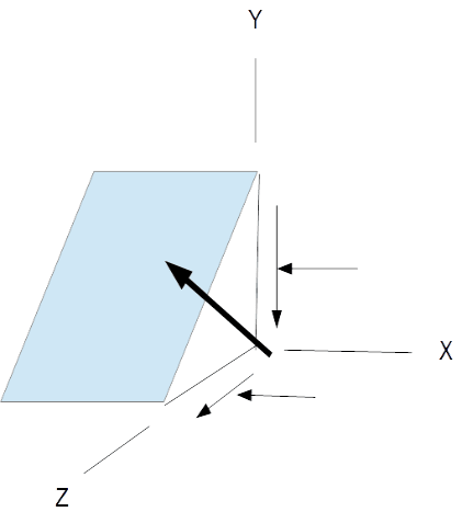

Weldment is a 3D element, thus subjects to stresses in all three orthogonal directions. The weld design stress/force is the vector sum of all stresses/forces.

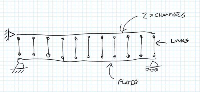

I did some more thinking on this while I was sleeping which can be dangerous. What you have got is three bits of steel constrained to the same deformation with centroids aligned. With all the load being introduced via the plate to the system. One way to think about this scenario is that the loads are shared based on relative stiffness, work out the relative stiffness and you know the loads going between each member, size the welds for this vertical force. You have the added complication of getting the loads out at the ends of the channels.
It's fundamentally no different than making a flitch plate out of timber/steel/timber plies. Provided that the centroids are aligned, there is no shear flow. It is simply some members with dissimilar stiffness sharing a common load. Once you know the stiffness and how the loads are transferring between members and introduced to the members you can design fixings between the plies to carry the proportion of the load required to each member and follow the loadpath required for equilibrium
If you had to build some sort of model to represent what is going on regarding the vertical load transfer perhaps you could do something like this. With pin ended links constraining the two members to the same deformation under whatever loading you were applying. Load in these links is going to give you an indication of the vertical load transfer between the elements. This vertical load transfer is what you should be designing the welds for in my view.
Agent666, I mentioned the concept of treating it as 3 separate sections and splitting the load based on the the stiffness - but you’re transferring the vertical shear in the channel web to and from the plate via flange bending, so I wasn’t sure how effective this would be, feels like that load transfer might be a bit soft to say its fully effective. In terms of the model you proposed, your links wouldn’t be rigid (channel flange bending) and the load would only be applied to the plate. The pin support on the channel would be a vertical roller...only the plate is supported/loaded.
