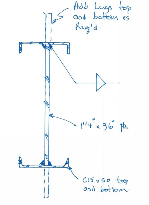

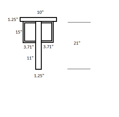

I have the below scenario: How do I resolve the force being applied to the welds given a max shear and a max moment (developed from shear-moment diagram).
The orange dots represent locations of the fillet welds. Channels are 15" deep. plate is 36" deep.

Yeah, we're killing you here. Sometimes we get so bunged up in fancy theoretical fun that we forget that we're dealing with a real engineer trying to solve a real problem in an expedient way.
The sketches below show how I'd tackle this if were a real problem crossing my desk. Go forth and be profitable my friend. Expend your serious mental horsepower on some problems more worthy of it.

KootK (from the PDF markup) said:
If you want to save a little money on this, I guarantee that one channel will suffice
KootK, I have a mountain of internet-respect for you, but you are adding to a pile of bad and now dangerous advice. Have you seen the proportions of the plates and channels he is using? Plate is 1.25"x36" and the channels are C15x50. You can check my math, but I get a radius of gyration of about 2" in the weak axis. Unbraced length is 40', so kl/r is about 240...this thing can't even function as a proper compression member over 40' with two channels and you're advocating for a single channel. OP has stated he hasn't checked for LTB and doesn't know how - this isn't the time for OP to just solve this in an expedient way.

Agent666 said:
Load in channel can resolve through the channel web and doesn't necessarily need to go through the plate.
I suppose you could say the same for a rectangular hollow section. How does it decide whether to use its left web or its right web?
Is a weld's stiffness so low that channel's web has more control over the flange tip than the plate that is welded directly to the tip? I wouldn't have thought so, unless the weld is undersized.

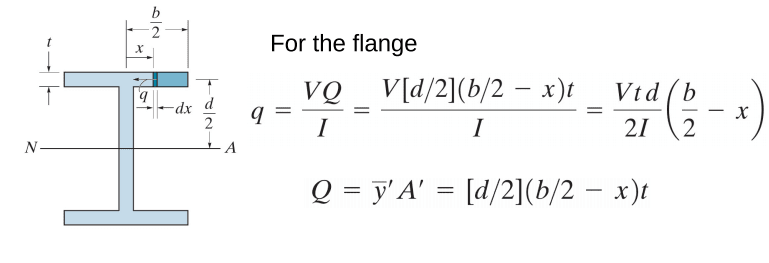

steveh49, if you take just the channel flanges as effective then there is shear flow in the welds. I don't know if you read through this whole thing, but there are bigger problems here than shear flow.
JP20 said:
Can someone break down how you convert a moment to longitudinal shear?
CANPRO said:
This right here makes me want to give up - I think it is has been made clear in this thread that you don't need the moment to calculate longitudinal shear.
Different people think and understand differently. Whilst there is another way of calculating this, working with longitudinal stresses may be easier to understand. The explanation in the image below works in terms of longitudinal stresses right up until the end, when V=dM/dx is substituted. I've used this to help explain this to other engineers in the past when they just couldn't grasp the V*Q/(I*t) method. Then they see the physical meaning of Q.
I agree 100% and I love to see someone approach a problem differently than I do so I can learn. However, to suggest that you can take the moment value at any given location and turn it into a longitudinal shear is fundamentally wrong - there is no other way to look at it. I've mentioned this example 3 times now in this thread - a simply supported beam with a uniform load has its maximum shear flow demand at the supports where there is zero bending stress.
steveh49, I get that you understand this and that you're suggesting to use the bending stress to help rationalize shear flow, and from this thread it is apparent that a lot of engineers take that route. But clearly that is not effective because some of engineers responding to this thread have a fundamental misunderstanding of shear flow.

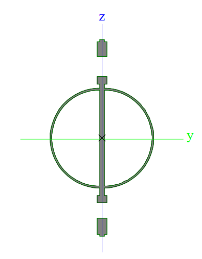

I think we've gotten quite caught up in semantics around shear flow here. Trying to put that aside, and in light of the OP's beam dimensions now being clear, I will provide some input on the design of lifting devices such as this one. I have designed several and analyzed them for more load cases than I can count. Generally, here is how I have approached these multi-hole lifting beams:
- It is often easiest to have a central plate provide the vertical shear capacity, and have it protrude above and below the lateral bracing portions of the cross-section so that you can drill holes and use those portions as lugs. That is perfectly vanilla.
- These devices are susceptible to both local and global buckling. The protruding, unbraced webs often limit the allowable stress due to their tendency to buckle locally. Because your top slings are not vertical, your lifting beam is exposed to combined compression and flexure, making it susceptible to global buckling (KL/r stuff). There's a double whammy with the flexure as those angled top slings both impose compression and additional flexure due to their eccentricity relative to the beam neutral axis.
- Due to the susceptibility to global buckling, I have always designed these devices to be quite laterally stable. Use closed circular or rectangular sections to prevent LTB sensitivity. Make these portions significant so that the beam is stable, and you can also utilize them for additional flexural strength. Your central plate should not constitute the majority of your Ix. A typical cross-section (with lug holes shown) is shown below:
- I take the weak axis design quite seriously. There's potential for a suspended load to shift or induce slight lateral loads on the beam, which we know is susceptible to global buckling. I have generally designed the weak axis stiffening elements to be able to yield without splice connections or welds failing.
OP, if you haven't written us off here, you might want to reconsider your choice of lateral stiffening, and choose something that maximizes the geometry of that stiffening (such as shown in the image above).

- I agree with you regarding the "effective cross section". The flanges of the channel are not going to transfer vertical shear into the channel webs, at least not much of it. The effective cross-section essentially looks like a WF section with protruding webs. I am including your sketch below for everyone's ease of access. In that case, and using your linked shear flow document, the shear flow would be given as shown below:
- Following that, the approach that I suggested early on of resolving the flexural moment in the channel into tension and compression loads that are carried by the weld seems invalid. I'll admit that deep in my gut I still feel that there's efficacy to that approach. I back-derived the approach, and it yields very near similar results. My approach almost matches the generic shear flow equation, but includes a term to account for the flexural stiffness of the flange which I believe is ignored by the general approach to shear flow. Bottom line, I think we agree, and would arrive at similar results through different approaches. Your approach is definitely more textbook.
Thanks. Let me throw this out there... thinking about changing the section to the following so the compression will, without a doubt, be transferred to a wide flange:
Replace the channels with stiffer angles might help. Also, why not use standard WT section!?
Craig_H, I agree with your last post. I understand your gut feeling on this, shear flow comes from the change in bending stress so it isn't a stretch to associate the presence of bending stress with shear flow. On the surface, it is very intuitive to follow the approach that was incorrectly presented in this thread (using bending moment to get shear flow).
I think what you were alluding to in your statement about flange stiffness (and I think retired13 was trying to make this point earlier) is that if you look at the weld as part of the cross-section, it does indeed see stress from bending. But with shear flow, we're looking at the weld stress developed from two components trying to move relative to each other - this is the critical stress when sizing the weld, this is the load that will cause a failure plane within the weld itself (traditional weld design, weld shear at effective throat).
JP20, the channels can't easily be positioned that way - you're going to have a decent size fillet weld between your two 1.25" plates and the channel won't fit there unless you notch the top flange. If you really need to make this work with the material you have on hand, I believe this is your best shot - turn your channels into flanges and use the 1.25" plate as the web. The channels give your compression flange great Iy properties. And I think this gets us back to a shear flow condition that we can all agree on. Please review the list of topics from my previous post - I feel as though you're still missing key concepts required to make this a safe design.
