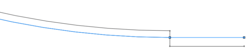

I'm a designer - there is a recurring theme with some parts we've seen recently, where there is a sharp step right where we'd least want one. We battle with other departments - they say it meets the print, we say it doesn't.
For example, we might design a bracket with a fillet/blend specifically to avoid a sharp internal corner for stress reasons, but we control the size of the radius or the adjacent flat surfaces with a profile tolerance - say .015 (we use inches). I realize this allows for considerable surface variation (like they draw in the GD&T books!), but we also have a block tolerance surface finish of 63 or 125. Here's an image of it (blue is as-built, grey is as designed):
You can see there is a step near the root of the fillet. Likely, this was machined with two different tools or from two directions, so I understand HOW it happens. At prior jobs, quality would have rejected or reworked the part. At the current job, Quality says "because the step is within the surface profile tolerance, it meets print."

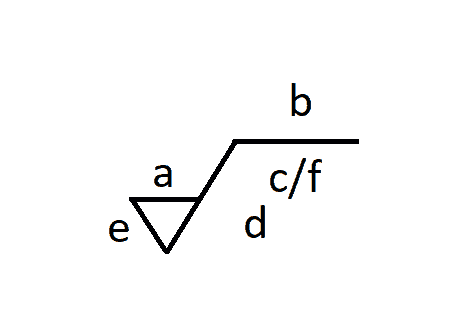

I originally thought block tolerance surface finish of 125 Ra should cover it. I then thought maybe we should say this is a controlled radius, but we see steps at the tangency point. The more I consider it, our surface finish should call out an Rmax that prevents this. I'm particularly concerned if this happens on aluminum parts prone to fatigue.
How do other people control for this type of manufacturing artifact with the print?

1. Try to specify "non-uniform" profile zone (see picture).
2. If your shop still try to justify abrupt changes within the tolerance zone, the "per unit" control is not only for straightness / flatness:
SBlackBeard,
I would argue that your step is a feature you did not specify, therefore you reject the part.
In a court of law, your vendor may be able to prove his part meets your specifications. Don't deal with that vendor ever again.

Out side diameters and adjacent shoulders it is very simple to turn the radius, and adjacent shoulder. Where it get difficult is inside diameters and adjacent shoulders.
Where on a single tool can be used leaving no step.
In an id if there is no clearance it may require two or more tools and a step may be unavoidable. I suggest in such cases a .005 max step on all surfaces. Excuse the typing ol cell phone.
When milling steps are unavoidable and have to be smoothed out by hand. Requiring hand blend. And is time consuming and expensive.
So only add no steps allowed when absolutely necessary.

Does that notch conform to your surface finish specification?

Would specifying a controlled radius work here?

@drawoh - yes, I agree, surface finish was my go-to, but I think the standard block tolerance uses Ra as 125 - letter 'a' below. My thought was that maybe I could put an Rmax of .0002 on the print? That would be where letter 'b' is below, so I'd have to change block tolerances or add a new note.
@SDETERS - I'd thought that too, but this step is really at the tangency point. How do you specify the quality of an implied tangency?
I feel like I just want to write a nasty-gram to Quality and the Vendor, but I'd rather make a change to all my prints in the future that is defensible and parts don't get here that I need to argue about. So far, Rmax or "No steps" are the leading candidates. Appreciate the opinions, keep them coming!
This is 100% correct.
The question of "What's the violation?" is 100% valid. This is a drawing issue, not a supplier issue. You are correct to strive to fix the drawing rather than strive to fix the supplier. Everybody wants craftsmanship but nobody wants to pay for it, so being specific about the part requirement on the drawing is crucial. I've seen some good suggestions with other responses. CR is one possibility. Controlling the radius with profile on a per unit basis is another possibility. Something as simple as the note that was suggested is a good one too.

I looked at this case in more detail, because it did seem like surface finish wasn't met... even though block tolerances call out Ra and not Rmax.
Working in theory and general terms is nice, but this specific one had a .003" step.
I drew it with the fillet, but it likely works about the same assuming it's flat.
In a spreadsheet I wrote out the deviation as .003 for 8 lines (arbitrary) and .000 for 12 lines. The average value is .0012. Ra is the average of the absolute value of the difference between the average and the actual for each line. So a step of .003 minus average of .0012 = .0018 for the first 8 lines, then for the next 12 lines, the absolute value of .000-.0012 = .0012. The average then equals (8*.0018+12*.0012)/20 = .001226 or an Ra of 1226 microinches. I did this again assuming it was a ramp from 0-.003 across the first 8 lines (.0009/.0012/.00015/.../.003) and then .000 for the next 12... that's an Ra of 806 microinches. I then dialed down the step height until the Ra calc equaled 125 microinches - you'd have to have a ramp of 0-.0004" or a step function of .00026 to meet an Ra of ~125. Even if you play with the number of lines that contribute, the answer stays in that ball park. If 19/20 lines are .00026 and one is 0, Ra is 153 microinches. If 1/20 lines is .00026 and the rest are .000, the Ra is 107. Anyway, not sure everyone will follow that but the summary is that it looks like if you were to swipe a profilometer across any step that is a few tenths high, you'd fail surface profile requirements, even when they are expressed as an Ra and not Rmax. I'll see if I can validate this with an actual profilometer and a .0005 feeler gauge.
