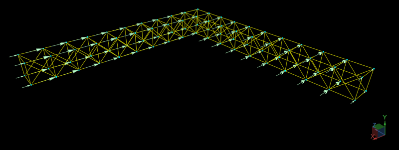

CrabbyT
- Feb 12, 2019
- 165
This post mostly concerns ASCE 7-10 Chapter 29 (Wind Loads on Other Structures), but I'm curious to hear other answers if people can provide insight.
For wind perpendicular to a truss, I'm familiar with using F = q∙G∙Cf∙As where Cf is based on Figure 29.5-2.
For wind acting in the longitudinal direction of a box truss (i.e. wind parallel to the truss' span), do you know of any guidance for how those forces should be calculated? Or, is there any code-justified method of using something other than Cf = 2 with point loads applied at each panel point as shown in the image below?
For wind perpendicular to a truss, I'm familiar with using F = q∙G∙Cf∙As where Cf is based on Figure 29.5-2.
For wind acting in the longitudinal direction of a box truss (i.e. wind parallel to the truss' span), do you know of any guidance for how those forces should be calculated? Or, is there any code-justified method of using something other than Cf = 2 with point loads applied at each panel point as shown in the image below?
