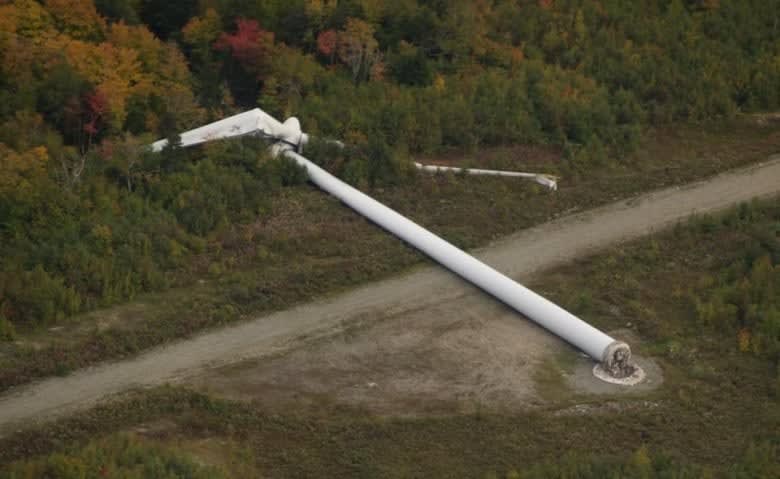

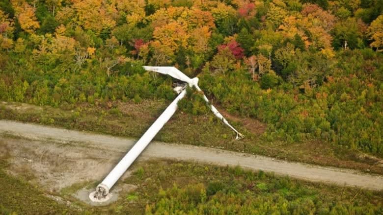

Would be interesting to see a closeup of the bottom of the pole. The article said it was a failure of the foundation, but is it rather a failure of the connection? The footing doesn't appear to have moved, but then that is impossible to tell with a distant photo.
Doesn't look like the foundation to me. Looks the pole snapped its attachment to the baseplate.

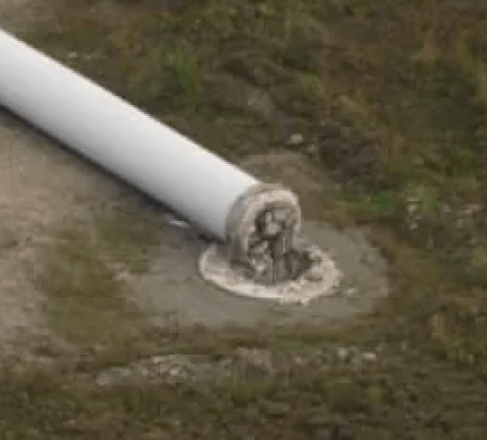

From the images I've seen, it looks like the anchors ripped out of the concrete base, or at least that's the impression I got. These are the only two images that I could find that shows where the failure occurred. I just wish they had some higher resolution photos so we could zoom in on the relevant area:

From images linked in above posts
Enlarging the photo of the base hints at what I would expect if the anchor bolts pulled out of the concrete. Better post accident pictures would be nice

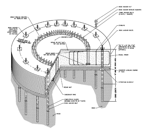

The following drawing looks somewhat like the pictures.
[URL unfurl="true" said:
http://getdrawings.com/get-drawing#foundation-drawing-5.jpg[/URL]]
This is one of the situations where the cost of not fulfilling contract obligations related to delivering power could be larger than the large cost of replacing the foundations.
Looks pretty much like that central structure has ripped itself out of the base.

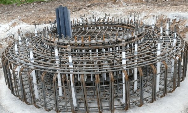

Is there only one set of top bars crossing the failure plane?

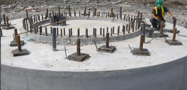

In the photo with the guy in the green hat, it almost looks like there are some cracks on the side face that have already been repaired in some fashion.
If that second picture is accurate it looks like there Sis only on set of top bars across the failure plane in shear?
The base of the anchor bolts for the turbine seem to finish above the level of the bottom bars.
Yea seems likely it was a breakout cone type failure propagating from the lower anchor ring. I’ve seen other wind turbine foundations where the center area is thickened at the bottom so the ring plate can be set below the bottom mat.
As stated in the original article, the defective foundations are in sections one and two of the wind farm and not in section three. The construction photos are of section three.

It's an interesting foundation design. The pole anchorage tension forces have to transfer over to the deep anchor rods - big shear in that section. I don't see any stirrups in the photo. Does that failure photo show a shear failure? Like a diagonal break?
I've never liked the the double bolt circle arrangement. Usually the larger circle resists a greater amount of tension than the inner circle but I have seen pole designers take the average diameter for the section modulus.

To me at this point, it looks like the break is between the pole anchor rods and the out tie-down anchor rods. An up close would be helpful.
a better picture would help... I thought just above the anchor rods.

Thanks, dik. A possible circular ring of cracks might appear before the final failure. I'm good at taking pix's of cracks. It's possible because of a lack of stirrups - say at 4 to 6 inch spacing. Could be wrong. The sketch provided - which may not be from this project shows a stirrup which appears to have a note on spacing. The picture of the steel placement doesn't appear to have any stirrups.
