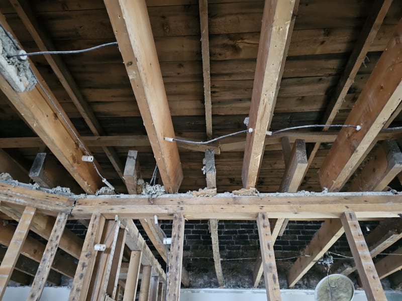

The question is simple: WTF is this roof framing? I have never encountered this before and it's super odd to me. Looking for any information...
Specifics:
3-storey above grade building (no basement) with flat roof is in Ontario, built in late 50s/early 60s according to the new owner. Structural masonry walls (double wythe) all the way up. CMU foundation walls. There are central load bearing walls and the floor/roof framing runs in the short direction of the building. Floor framing is 2x10 at 16" with one end supported by the inner wythe of the exterior walls and lapped over the central walls.
But the roof framing... the ceiling of the top floor is 2x10 at 16", as with the floor, but then there's these "box trusses" (which aren't actually trusses) that run in the long direction and bear onto the rafters. These box frames (which are spaced like 6 to 8 feet apart) create a roughly 24" plenum space which was filled with insulation prior to abatement. On the box trusses, additional 2x4 rafters at 16" are installed in the short direction, parallel and generally in line with the 2x10 rafters framing the ceiling.

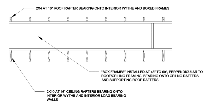

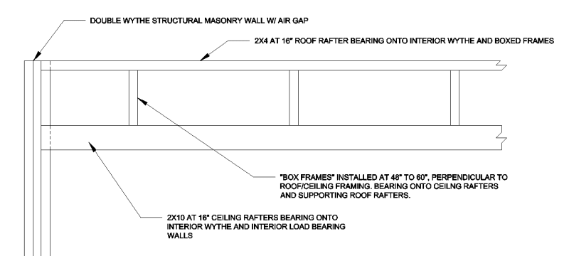

Hi Harbringer. Sketches are pasted below. They aren't pretty, but they're quick...
I have no clue what these repeated frames are, so "box frame" is my rinky dinky forum terminology while I get educated. I tried to find them online but found nothing. I guess you can call them a pony bearing wall or something similar. Perhaps that's all they are.
I agree that the ceiling rafters (the 2x10) are carrying the roof load, 100%. I'm more curious about why this framing was done this way and what considerations I should keep in mind when dealing with it. Thanks for your input.

The box frames look to be transferring the roof load to the CJ's as the rafters are undersized and providing the slope. See this a bunch in my area in older masonry buildings.

Whatever might have been the original intent, this system creates a cavity for roof insulation and other services (electrical, mechanical). Quite nice, since it likely prevented the ceiling joists from getting drilled to swiss cheese by a century of careless service upgrades. And yes, I agree with SWComposites that the knob and tube shown was NOT installed in the 50s or 60s - this building is older. 50s wiring in my neck of the woods (Alberta) was generally quite hefty copper wire with a textile insulator.
The 2x4s only need to span 4-5 ft between the box frames and likely have catenary abilities due to the multi-span nature of each joist. Consider that and the fact that the wood is likely old-growth Douglas Fir with hair-width growth rings (can probably consider it to be SS grade in current material properties tables), and I'd wager that deflection works out. The box frames are simply creating vertical space, and the ceiling joists are doing the heavy lifting. Looks like it's all rough sawn as well, which gives you a good bit of extra meat in the components.

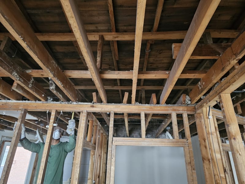

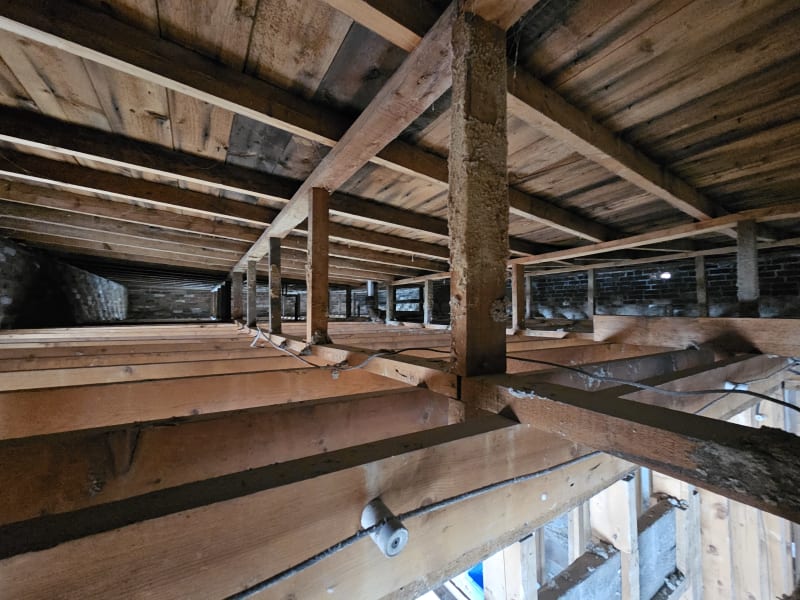

Thanks for replying. I agree with all of you on the load paths, and it's interesting that the building is older than the owner believes. I don't pretend to be competent in electrical/mechanical matters so I stay in my lane, as they say :) In any case, I went back to the site today and got better pictures. The box frames were broken in quite a few spots, and I have the contractor fixing them by replacing broken elements and then laminating 1/2" plywood (much like truss repair methodology) on each face. The ceiling rafters are rotating quite a bit so I have them installing blocking where rafters are lapped to prevent further rotation before closing it all back up.
Quite interesting to me. I agree with @Craig_H and will stop to try and figure out why the ancients have done the framing this way. Clearly it didn't work out because the top chords of the box frames have broken in many locations and the roof rafters are (IMO) spanning way too far. We have rough winters here and our snow load is 2.44 kPa, and then we also have to consider access loads and dead loads.

I wouldn't call those box frames, I'd call them knee walls. This is pretty typical in my area for older buildings, especially in the older down-towns with rows of adjoining buildings with monoslope roofs going back to an alley.

This is reasonably common in Ontario for certain types of older structures. In my opinion, a beautiful example of how things used to be constructed. Something must have been done reasonably well for it to last 100 years. Reminds me of the rough sawn 2x8 floor joists in my house that are 30 feet long as single pieces (two span), you just don't find wood like that anymore. In my opinion this type of framing has nothing to do with future storeys being added.
When I have seen framing arrangements such as this, the ceiling joists are horizontal and the roof joists are sloped for drainage. I have not figured out why the size of the attic space is as tall as it is, but have seen it many times in Ontario and Quebec. Deteriorated wood needs to be identified and fixed. It's a good idea to run some calcs to justify the existing framing, but remember that wood of that age is stronger than modern day tabulated values. Samples can be taken for species identification if necessary to refine design values. I am reasonably confident the original construction intent was for the pony walls to provide support for the roof rafters.
Thanks Canuck. I won't be taking samples or anything, however, since I am having them leave the framing as-is. It's grandfathered as it is and I didn't see any signs of rot, dry or wet. No framing changes to the rafters (ceiling or roof). Only modifications being done are to the pony walls ("box frames", so others can follow the thread) and only where they are disjointed or broken. In those instances it'll be a plywood lamination to both faces with installation of additional web stiffeners (or studs? whatever).
