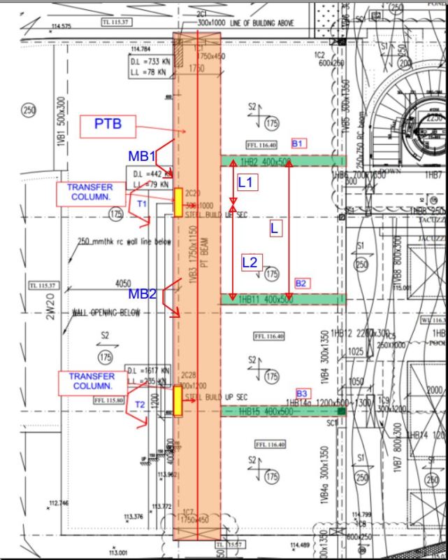

Hi everyone,
Good Day,
Please refer to above, I have a PTB supporting two transfer columns with eccentric torsion moments. The PTB section is not large enough for shear + torsion. I am thinking to use tie beams (B1, B2, B3) against the torsional rotation. Is it feasible?
If so, my questions are
(1) I understand that T2 will be directly resisted by B3. How about for T1? how will it distribute between B1 and B2. Will it distribute depending on the flexural stiffness and distance from the T1 of the each tie beam?
(2) If my tie beams can resist the torsional moment (T1 + T2), do I still need to design my main PTB for torsion?

The concept is feasible. My gut feel is that your tie beams are too small to make a go of it. Ideally, I'd like to see:
1) Deeper tie beams. Wider too. Matching the column width would be nice.
2) Tie beams coming at the transfer column locations in all cases.
3) Tie beam reinforcing extending all the way to the left side of the PT transfer beam.
In both cases, the load distribution will be a function of the relative flexural and torsional stiffness of the various members (PT transfer beam, tie beams, adjacent slabs).
At minimum, I think that your beam should be adequately sized and reinforced for shear + compatibility torsion. Additionally, you may want to give some consideration to the serviceability implications of redistributing the torsion in this way. You'll get some torsional cracking prior to the redistributing the torsion.

1. What is the percentage of T1 that will go to B1 and B2.
Is it Moment to B1 (@ left end of B1) MB1 = T1 x L2/L?
2. Any recommended software to do design torsion?
And again thanks!!
1) I would consider your proposal to be a valid way to estimate the upper bounds design forces on the tie beams. For the torsion design of the transfer beam, however, I'd recommend a more detailed analysis accounting for the relative flexural/torsional stiffnesses of the tie beams and transfer beam.
2) If your in-house PT software doesn't handle torsion design, an Excel/MathCAD spreadsheet of your own is probably the way to go.

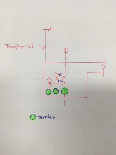

Hi KootK,
(1) In my tie beam concept, PTB cracks under torsion and I will provide more than minimum crack control torsion links.
(2) I have this idea. "Instead of adding additional tendons for torsion, will it be better to position my flexural tendons unsymmetrical as shown below?" And still provide tie beams.
I worry that your tendon layout will create a tendency for the girder to flex to the right and, when prevented from doing so by the adjacent slab, will result in a counterclockwise torsion in the girder which will undo some or all of what you're trying to accomplish. That said said, if you account for that and there's still a tangible benefit to your layou, then you might be on to something.
To some extent, I'm sure that your torsion will get absorbed in to your high and low slabs just as much as your relatively shallow tie beams. It's just still difficult to figure how much force goes where. A belt and suspenders approach surely has some merit here.

I would prefer to have the transfer beam central on the transfer columns and take the torsion out at the end supports with a couple of transverse beams if possible. Or the transfer beam itself might be sufficiently stiff on 2/3 of the end columns as a cantilever.
For the current configuration, you would have to analyse it in 3D to see if the transverse beams are stiff enough to take out the torsion. With your current dimensions I would doubt it. I would prefer them to be the same depth at the transfer beam. The width would probably be ok in that case, but you need to analyse it to see what rotations you get.
Agree also that they would be better lining up. If they do not, you will have to design for the torsion developed for the column above causing torsion to get the reactions to the split transverse beams.
The torsion is not being caused by the prestress. You are allowing for the stresses to distribute evenly over the while beam shape plus flanges. To do so will cause torsion. I think you are playing games trying to get the tendons under the columns only. It may reduce the torsion slightly, but not worth the effort.
To design for torsion, all you need is your calculator to extend the shear calculations to allow for torsion. Good for the soul!!
