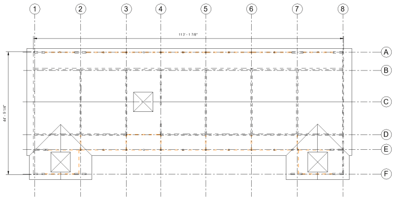

I am looking for software or Exel sheet that will calculate the wind pressure based on ASCE 7-10 or ASCE 7-16 using the MWFRS Directional procedure.
so far I found two anyone have exprince with that can give me advice
#1 Wind simple - S. K. Ghosh Associates Inc #2 skyciv - this one is cloud engineering software

@AaronMcD , Because I can't use envelope procedure for low rise buildings .
Per ASCE 7-16 low rise building has 2 conditions
1- Mean roof height h less than or equal to 60 ft
2- Mean roof height h does not exceed the least horizontal dimension.
I am designing a motel has a Mean roof height more than the least horizontal dimension. so I guess I need to go with the directional procedure. or there is another solution for that
