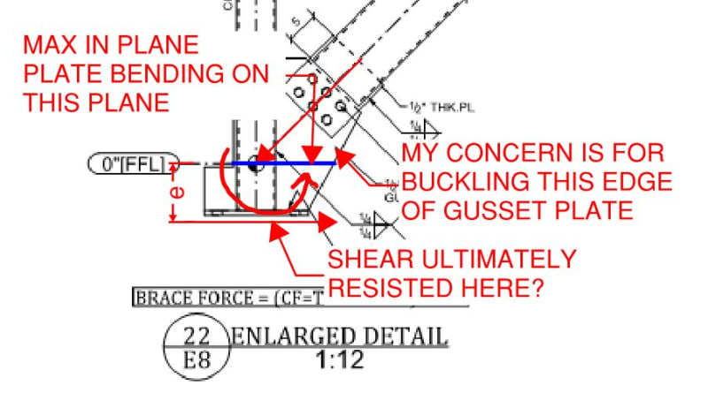

Hey guys, i have a situation where my detailer slotted the tube column at base plate due to its larger brace force, however it seems to be wrong as far as i know, has anyone encounter a same situation?

I've seen it, but never don that. I rather think it is a very sound solution than using a large gusset plate. The only thing bothers me is I don't know how to analyze the gusset as shown now.
If that diagram is at all to scale I'd still want to check the buckling strength of the eccentric 1/2" plate.
That is a big brace for a 1/2" eccentric plate brace.
Just to add to this. Surely it isn't up to the detailer to design critical connections. This one seems to need some pretty close attention and from what I can see the detatiler has done a reasonable job by choosing to slot the column. But there there is plenty going on here so I'd expect that it be fully engineered.
As I am aware off, the detailer's office usually have structural engineers (licensed, or by trade) to perform one job only - design the connections.

I would still look into the eccentric nature of the loading of the 1/2" plate. It is a commonly overlooked item and has resulted in failures. 1/2" seems too small for that brace if the diagram is to scale and if it is a single offset plate (as opposed to a sandwich plate.

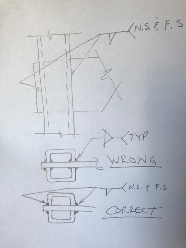

Those 1/4 in weld symbols are wrong. Essentially they are demanding that you weld on the inside of the tube column to the gusset plate. They should rather have only used the fillet symbol on the bottom of the weld line, used two arrows, one pointing to the right side of the column and a separate arrow pointing to the left side column-gusset interface, and then include a comment “Near Side and Far Side.

In my opinion, slotted gusset connections are one of the very best versions of these style of connection. It is one of a very small number of connection typologies that will convincingly produce concentric load transfer between the brace force and the column vertical force. Given how narrow your column looks relative to your brace here, that feature may be important to reduce column moments.
The main reason that you don't see slotted gussets more often, in some markets, is simply that they are more expensive to fabricate than other, non-slotted connections.
I hear it. Particularly so since, in this case, the gusset probably needs to resist in plane bending as a result of the brace work point coming in above the final point of shear resistance (base plate I assume). Were it spatially tolerable, I might like to see a stiffener on the underside of the gusset just to take compression edge buckling off the table when the brace is in compression.
That's interesting and something that I've always been confused about. Is the way to interpret near/far: both sides of this solid plate element?
For the sake of argument, imagine that our column here was really a double channel. Would OP's weld symbol be appropriate then?
KootK,
Your interpretation of weld symbol is correct. But looks like this guy missed two locations, one on top edge of bracing-gusset connection, another one on the back edge of column-gusset connection. But since all welds on the gusset is the same size and type, the omission shouldn't be a big problem though.
Guessing from the geometry, the 1/2" connecting plate may suffer approximately 15 kai compressive stress. It's ok, or not?

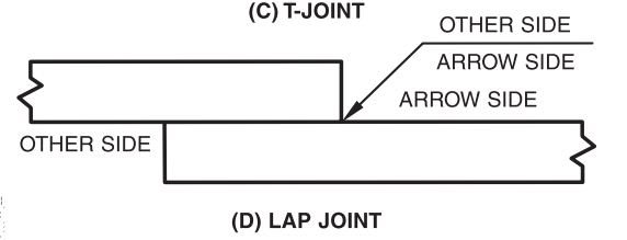

KootK, per AWS, a double fillet weld symbol is telling the welder to weld on each side of the steel-to-steel interface, which in this case would be the two sides of ONE tube wall where the gusset cuts through the tube.
This is probably not the intent of the person detailing the weld and is probably not even possible to perform.
I believe the correct weld symbol would be as shown:
Yes, a little note makes things much more clear. But, unless for very short weld length, the welding of inner tube will not be performed, only the engineer may have to response to a nasty RFC then.
I couldn't say as I've made no attempt to evaluate it. However, were I do do that:
1) The compression stress would include the effect of bending, as shown below.
2) My evaluation would include a look at plate buckling rather than raw comparison to Fy.

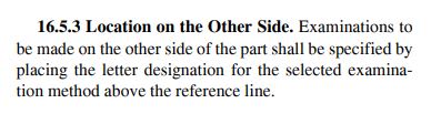

With respect to the weld symbols, I decided to go back to the source (AWS) to review the exact language used as it's been a while. The language I found was "other side of connection" and "other side of part". While I find those to both be a bit ambiguous in this respect, there were also a bunch of sketches and not a one of them suggested anything other than JAE's interpretation. The only one that drifts a little is the sketch shown below which starts to feel a bit like my channel example (why I asked of course).
