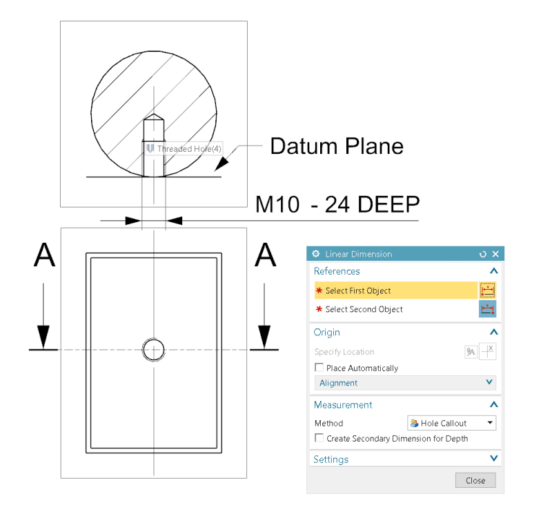

Hole callout on circular surface does not work. Please help.
Thank you,
Trent
NX 11.0.1.11

That is a known issue.
A workaround is to create a tangent Datum plane first on the cylindrical surface. Use that to place the hole feature.
Then your callout will work. I believe it has been fixed in NX12

The datum plane workaround did not work. So LAME that it took them 12 versions to fix a "known issue". I guess I can say, I'm looking forward to NX 12 as we are still using 11.

On NX11.0.2 it is working, but only for Linear dimensions.
The radial dimension doesn't work.
