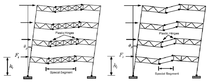

I was wondering what would be the correct seismic classification for the attached frame. It feels like this is an obvious "moment frame". Lateral resistance is provided by the moment capacity at the column beam connection location.
On the other hand, everything is nearly purely axial. Every action translates into axial compression & tension. And this confuses me if we think about seismic systems and ductilty. Imagine I have to pick a high ductile system. Should this frame be "special moment frame"? I have serious doubts because in order for R to be 8, we should have serious plastic deformation capacity at the "beam" and moderate plastic deformation capacity at the panel zone under cyclic loadings. I am not sure if we can achieve this with axial deformation of the members. Also, High ductile moment frames have very compact beam flanges. How should we project this requirement to truss frames, I dont really know.
I am not aware if codes directly adress this type of frames but they are not rare for the industrial facilities. And sometimes, due to cranes etc, roof load can be high resulting to prevent us from usign R=3 systems. I wonder what would be the opinion of the forum.
