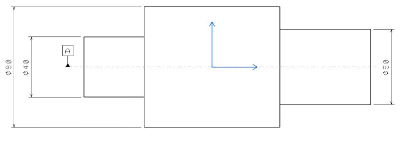

Hi All,
Let me write my first post at this forum since I read many hints and tips, which help me in my daily job.
We had a interesting discussion with the team about considering a datum which is placed directly on the axis. I am aware that it is fault, and datum has to be connected with physical feature to be able to derived from, but in many cases we met the situation and finally we have to face it. What is the proper way to deal with it and how to find the axis from 3 diameters? Unfortunately I couldn't find any useful information...
If your part works in the assembly as you described "............to find the axis from 3 diameters" (which is highly unlikely) then use A-B-C as your primary common datum axis.
Describe how this part is assembled and maybe you can get better answers.
While it's true that showing a datum feature symbol on the center is incorrect, sometimes we can figure out the intent if we can see how datum A is used in a subsequent callout.
I suspect that they didn't want to make datum A from a combination of 3 centers (you could do that with hyphenated datums, as greenimi mentioned). But seeing the full GD&T could help the reader deduce the intended idea.

Hi, no_marcin:
It is called "Multiple datum Features". You can use A-B-C as greenimi indicated. But I doubt you have such design intents in your application.
Below is what ASME Y14.5-2009 says about "Multiple datum features" (page 65 section 4.12).

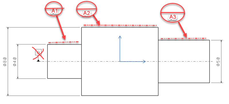

Tick -- datum targets are best when you're using only a portion of the physical feature to create your combined datum.
If the target encompasses the full length, then we'd just keep it as a full letter and use the hyphen method.

p.s. I humbly accept the knowledgeable correction regarding use of datum targets in this case.
