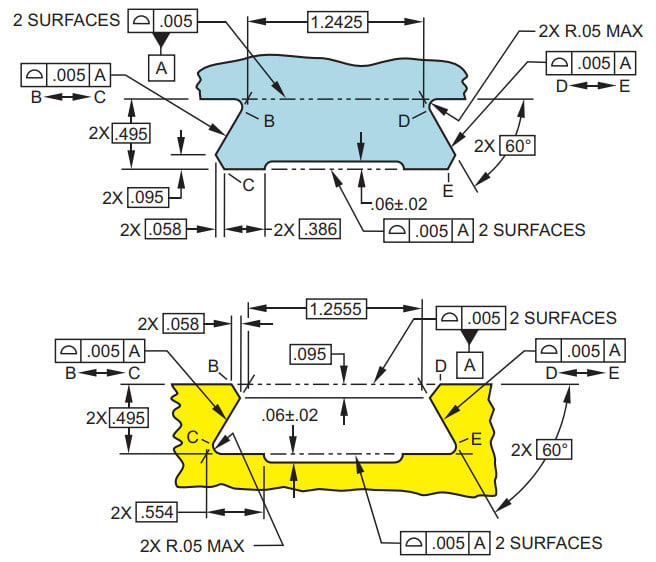

Expect this figure will give you some idea on the dimensioning and control of a tapered slot surface(surface S and surface T on your case).
Season

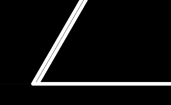

It looks like that diagram allows for an interference fit between those two parts. This is the nominal geometry with the line width representing the profile tolerance. If the tab moves enough to clear the bottom of the slot the sides of the tab may interfere. There was enough room for side-to-side tolerance, but not on the depth.
It also suggests an ambivalence of having a fit that traps the tab between the wedge and the top surface to limit vertical movement or between the bevel and the bottom of the slot. If the latter, there is a gap that is forced at the upper horizontal interface so that any vertical load is taken only by the small flats.
It would have benefited from using unilateral profile tolerances.

Actually, I prefer to use profile tolerance, as suggested by SeasonLee. I think that is the most reasonable approach.
A compound profile tolerance would control form and orientation separately. Or multiple profile tolerances referencing different datums could control movement relative to those datums independently.
However on this particular blueprint, it is a legacy part. The company has inspected the profile of similar dovetails via optical comparator for at least 75 years, and separately inspected the location in a similar method to what I drew. I'm not intending to change the inspection method on this particular part. So, I think a note is warranted here.
The impetus for the change is to digitize this old blueprint and correct some conflicting requirements (which are confusing). As it turns out, manufacturing and quality are doing the right thing, but the drawing is in need of some love. I'm trying to correct the errors and digitize the print without changing the actual inspections, if that makes sense.
