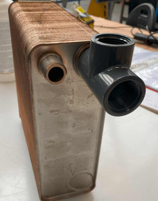

Is there any risk of galvanic corrosion if we connect this flexible steel tube directly to the heat exchanger: (I work for a French start up - your browser should translate).

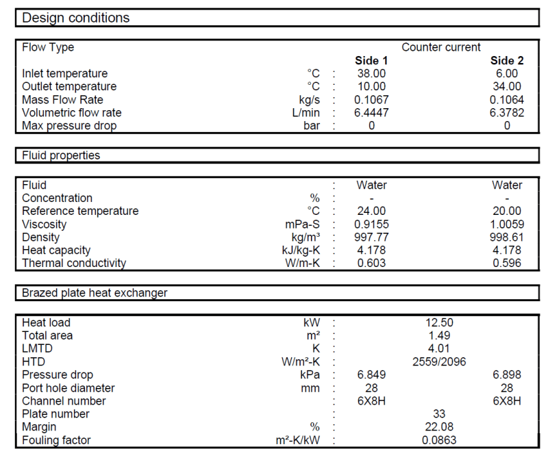

I have seen tables such as this:

currently no copper parts connect to the HX and I do not plan to connect copper to the HX again - it was only in the early versions like in the picture above.
We glue PVC parts to the inlets/outlets at the moment
as we discussed about, i will glue 304 elbows to the HX then attached the PVC parts to those.

So the HX is SS with Cu braze alloy?
The braze joints may be your weak link.

This is the HX
We currently use Loctite 480 to attach the PVC to the SS threads in the heat exchanger. No issues so far.
I plan to use FiletFix III to connect the 304 elbows to the HX. No issues when used to connect threaded brass parts.

Provided sulfides are not present and depending on the brazing alloy used you'll possibly see dezincification of the braze material before the copper corrodes. There is a very high ratio of brazed area to copper area in brazed plate heat exchangers which means the braze alloy will be anodic to the copper until the zinc is depleted.
The HX manufacturer has confirmed that there are only the 2 following materials in the HX
304 Steel
Pure copper (brazing material)
How does this change affect your previous post?
Thank-you
So the plates are 304 and copper is the brazing alloy? That's not good. You have a very high ratio of surface area of stainless steel to copper which means the brazed joints are going to corrode away very quickly if there is any conductivity to the fluid. The type of heat exchanger you have is for clean, non-corrosive fluids.
