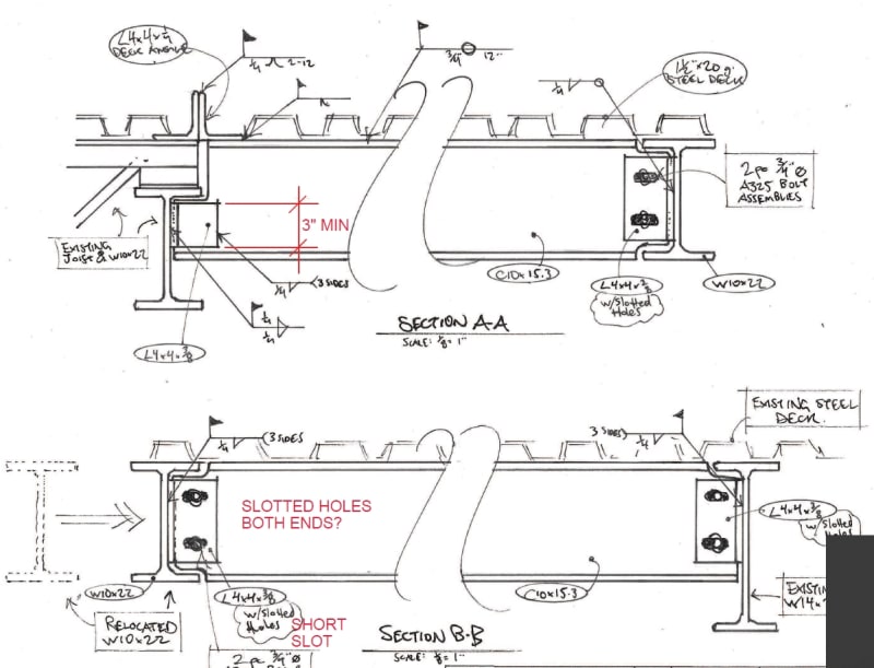

Can someone post here an example or an excerpt from an "attractive drawing"?

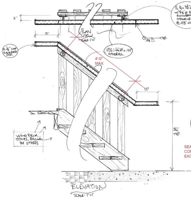

3DD... concur... my dad always used to say, "There's an elegance in precision."
There are much better and more intricate drawings than these, and more artistic... next time one pops up, I'll record it... but you get the drift. The red comments are mine...
