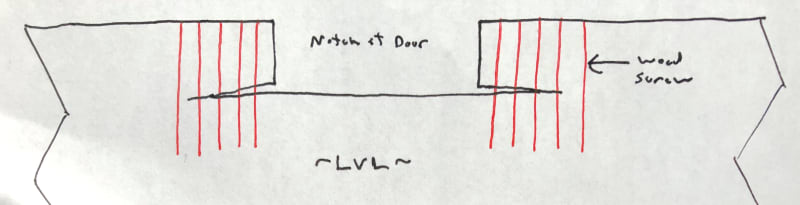

Here is my situation in an as-built condition...
If I model it as a 24"/16"/24" beam, the numbers work out for strength and deflection while ignoring the column. I want to ignore the column as it will be easier than trying to fix the sketchy load path. I will likely have the contractor remove it. Is there any thing to fix here?
The notching guide for LVL's allows a top notch of 0.4D max over 1/3 the span but it only addresses notches that start at the bearing. I feel like I am OK here though.

Where are you finding this in literature? FWIW, the beam cannot be reinforced without a huge amount of effort. It does not pass assuming it is just a 3 ply 16" the entire length due to deflection. Without the column, I am getting 2,400 PSI fb. With the column it reduces to 400 PSI.

APA G535 recommends compression side notches should only be made in areas of the beam stressed less than 50% of the allowable bending stress, and that the resulting net section be checked for shear and bending.
They also recommend radiused corners at the notch to reduce stress concentrations and splitting risk.

Good to know. I am at 2,400 PSI so that does not work. Looks like I need to make the column load path work. Again, the beam cannot be reinforced at this time.
Thanks for everyone's help.
That APA doc also strongly discourages any tension side notches, except at end bearings. Maybe you could add those long screws down the top on each side of the notch to reinforce the splitting plane. Not sure if that was what pham was suggesting, but I pictured something like this (from this white paper:
Maybe use long wood screws from above which would pass through the potential splitting planes, like:
I would start the screws something like a ratio of 2:1 relative to the notch depth from the edge, so about 16" in your case. I don't know the best way to calculate the splitting force on the screws without thinking about it more, but there must be a way.
Also, if it's possible to provide a slight radius at the notch ends rather than a perfectly square cut with a sharp edge, that might help. I suppose that's not possible if this is as-built.
EDIT: Basically what Bones posted 5 minutes before me.
Yea, great sketch. That’s exactly what I envisioned. That white paper has design procedures for this kind of thing.
