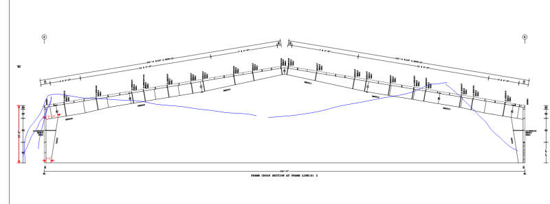

SandwichEngine, I'm still having a hard time processing it as well. Should have clarified; it's 240 LRFD / 164ASD, project is Risk Category III due to occupancy load and the controlling load combination is D+S (moderately high snow at pg = 42 psf) with the thrust equal and outward both ends (50' bay spacing also). But that's a great thought to verify the reactions (why trust the PEMB designer after all); I have a frame set up in RISA so I will run it tomorrow and see if I get anything close to what the PEMB preliminary RXNs are indicating. Typical frame preliminary RXNs attached for your leisure reading...
 https://files.engineering.com/getfile.aspx?folder=4b300841-d404-4571-b5d6-8ccc0ae23ba8&file=Monster_Frame.pdf

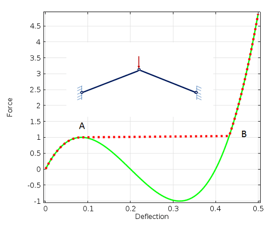

I do feel that is a very important aspect of this at the scale being contemplated. At the risk of being alarmist, it raises the specter of snap through buckling for me. I think that's a pretty unlikely outcome in any case but, man would it ever suck if it came to pass.

Anyway, I took a quick look at the reactions on the sheet you attached above and have a few comments:
[ol 1]
[li]Based on the frames being spaced 50' on center as you stated above, I assume that means the tributary area for the vertical column reactions shown on that sheet is 50' x 100' = 5,000 SF. Based on a ground snow load of 42 psf, for a 2:12 pitch roof, Building Risk Category III, and assuming Ce and Ct are both 1.0 (which might be a non-conservative assumption), I get a sloped roof snow load of 32.34 psf. Based on our tributary area, the vertical column reactions due to this snow load is 161.7k. I'm not sure where they got the 92.03k.[/li]
[li]Whoever is running the loads on this should also be accounting for unbalanced roof snow loads. I would guess that's what the "S>" and "<S" loads are supposed to be for, except that the reactions don't make sense in that case. With the unbalanced snow loads, you would obviously have different vertical reactions for the two sides.[/li]
[li]I assume the total dead load is the sum of "CG" and "D". That makes sense in terms of the load magnitude.[/li]
[/ol]
If the loading is wrong, you should get that ironed out first. For PEMB projects like this I usually spend a little time looking at the loading and reactions to make sure it's somewhat sane.
