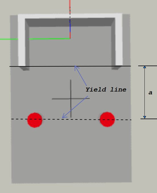

Hello,
How exactly do I calculate the effective bending line on a base plate like shown below?
I've read that there are 45 degree projection lines that comes from the bolts. What about the farther bolt from the bend line? Is that one also projecting and therefore causes a larger line?
Visually I am having trouble determining how this bending line comes out to be. I've seen in another eng-tips post that also mentions including the perpendicular distance as well, so not sure about that one.
Hope someone can point me in right direction.Thanks.

For the uplift, I would use Yield Line Theory. My belief is that the critical yield lines are shown below, but you could experiment to see if you can find a more critical one. So the base plate must be designed for a moment of Pa/2 where P is the uplift (2000# in this case). It is assumed that the channel is capable of providing sufficient moment resistance.

I agree with BA on where the yield line would be based on this geometry, however if you wanted a simple and conservative approach consistent with AISC DG1 that would not have to account for prying, I would design the plate for a moment of P*(a+0.1*b_f), referring to BA's sketch. The 10% of the flange width added to the moment arm accounts for some variation in where the section provides that flexural resistance.
I would not argue with adding 10% of the flange width, but the expression for moment should be (P/2)*(a+0.1*b_f) because there are two yield lines, not just one.

I'm not familiar with the AISC Design Guide in respect to base plate design, so I will have to check it out when I have time. At a glance, it seems to be conservative. But I cannot quibble about using thick base plates. I don't like to see base plates 3/8" thick. They tend to curl with the heat of welding. I prefer to use a minimum base plate thickness of 5/8" or even 3/4", which may seem a bit arbitrary, but over many years of practice, I can't recall anyone objecting.
Don't you need the column to be stiff to develop the second yield line near the channel toes? Obviously, the channel is not stiff in the weak axis.
For a singular base plate, I'd probably consider prying about the free edge and look at flexure at the bolt line for the design of the plate.
I like BAretired's approach on this one.

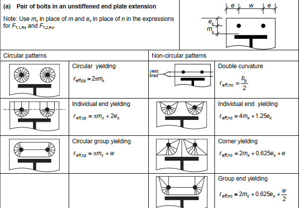

In the UK, we would mot likely adopt a T-stub approach, which is basically a yield line approach. An example of considered yield lines is below. It would probably need to be adjusted for your application:

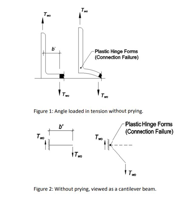

I see it as the channel and the weld group need to resist the total moment, let's say P*(a+e) where e is the additional distance from the yield line to the centroid. Fundamentally I don't see a difference between this scenario and the standard prying model (except the additional eccentricity) where the first hinge forms at the distance a and only once this hinge forms are the additional prying forces necessary for equilibrium, sketch below from the Carlo Lini article that explains better than I can here for the case without prying:
I am not against considering the additional yield line at the bolt line and the resulting prying forces, I just typically have found people are weary of using YLA on base plates - but apparently not this crowd, which is encouraging.
In Figure 1 the applied and resisting forces are offset. How is the moment accounted for? In a tee shape, symmetry provides the balance. In a single angle some other mechanism must form (unless the angle translates and the two forces line up).

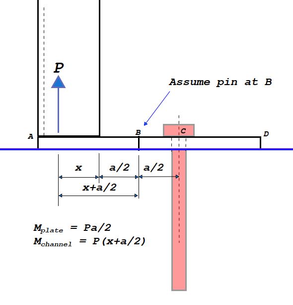

With a theoretical pin at B, the moment in channel and plate are shown below.
If the channel rotates, which it will, the pin at B will move left, so that Mplate is increased. The elastic moments are dependent on the relative stiffness of the plate and channel. If the plate is made much stiffer than the channel, the plate will take a higher share of the total moment P(x+a). For the small cost involved, I would not be averse to designing the plate for the total moment.
BA - I believe we're on the same page, I'm just making the case for not allowing the hinge to form at B as in your sketch and prevent prying forces from developing. That being said, if you do allow the hinge at B you need to account for the additional prying force in the bolt.
