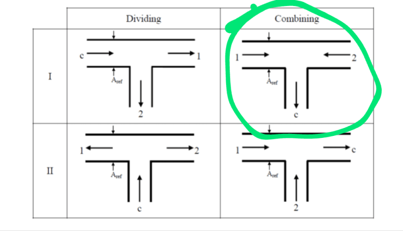

This is my flow situation:
You're correct in that square edge and opposing flows are going to increase pressure drop compared to radiused fittings.
Until we can see what space you have by drawings or pictures it's difficult to comment on any better configuration, but anything with radius or bends would be better than what you seem to have. Maybe even guide vanes inside the tee.

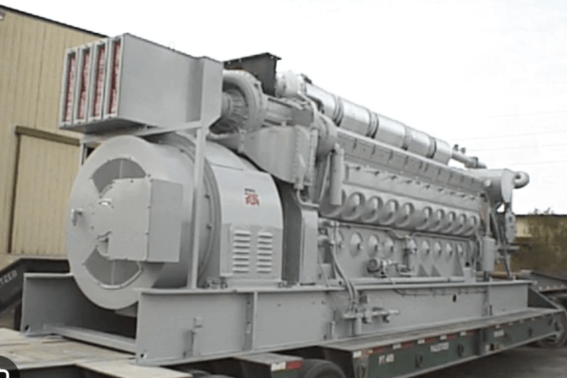

Here is the standard configuration. Air filter is the box on left side with red colored slots (those are the bags). I am flying down there now and will try to get on the boat if it's available.
Judging by the "standard" configuration, there should not have been a need to adjust the air intake. You'd need just as much (if not more) clearance between the bulkhead and both the conduit box (grey box at lower right below air filters) and the air inlet for the generator (open vaned area below the filters). Ballpark guess is that the generator manufacturer specifies something like 3 feet to allow sufficient flow at the air intake region. Conduit box should have a minimum 30 inch clearance (or the door swing, if that's larger).

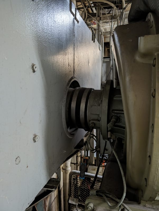

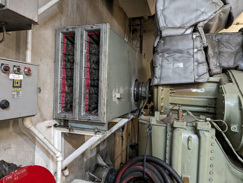

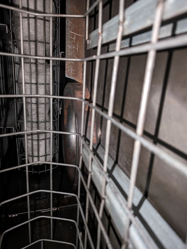

Got 'em. First pic shows external duct into turbo. Second pic shows clearance issue. Filter box is mirrored on other side. Third pic shows there is indeed a radius but it is raised off surface. Diameter of inlet is a about 8"
Third pic shows a rounded Inward Projecting/Re-entrant. Idk the K for that, but I suspect it’s closer to 0.78 than 0.28. And, the air has to turn 90o compared to the factory straight through flow path. That’s more K and not in the direction of goodness.
Good Luck,
Latexman
Higher, as flow is significantly more disturbed in 3D. You are essentially losing a 50% of volume in the approach path to the entry area cut off by the wall. It would look like half of the first diagram, where the bottom side of the outlet is a long horizontal line.
It's like attaching a horizontal discharge nozzle of a tank with the bottom at floor elevation.
To get full possible discharge, the nozzle must be located some distance above the tank floor. I'd estimate 2D above the floor.

One thing to maybe try is to increase the space of the plenum by adding two rectangular sections in the middle to create a bigger chamber. I think there might be an issue with the further two air filters not providing as much air as the inner two. A more central position would help if left as a single entrance.
At the same time make the air connection to the engine smooth with the wall like Latexman alludes to.
Or maybe extend the bottom section all the way as a half pipe?
It is difficult to get the perspective, but it appears to me that the filter bag we see in the third picture is masking off half the exit duct. I suspect it would be better to entirely remove the inward projecting nozzle for the exit air. When air is flowing through the unit, the bag will be sitting hard against the cage and mask off even more of the flow area.
